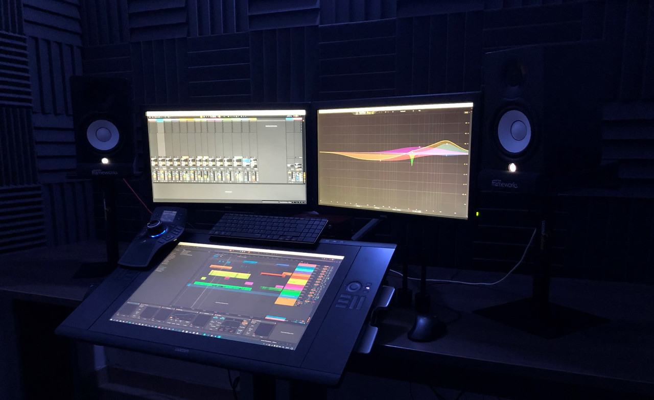

Yamaha HS5 + Room Correction are my suggestion. They are perfect for a small studio and they really dont add any colour to your sound. I do all my presets with these, and usually the only thing I need, when moving from different places, is a bit of EQ on the fly. Most important, they are affordable. :)
84833589-A00-E-474-A-BC8-F-50-D5-DFB530-
