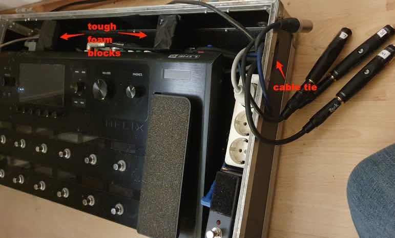

Absolutely. Here's a picture of my case. As said, this isn't a "made for Helix" case but one that I had been using for a plethora of other board builts already.
Might look a lot less professional than it actually is, but I'm using it like that for almost decades already. All the outgoing cables are fixed by a cable tie (the power cable is around 2-3 meters) and there's absolutely no tone suck or whatsoever by the jack extension adapters (no idea what you officially call them in english), they also hold any plugs pretty tight. The USB cable is a pretty short one that I just disconnect from USB extension cable, roll it up and keep it in the case as well. At home I'm running the two 1/4 outs into a little mixer, for live one of them (I'm strictly playing mono so far) runs into a DI box and then to FOH (would love to use the XLR, saving a DI box, but as Line 6 was too greedy to slap a proper XLR out in - one that would have no issues with phantom power), the XLR out is feeding my wedge or IEM mixer.
I would've loved to build a kind of patch bay in, but there's not enough space on this board - and hey, seriously, this is working 100% troublefree for years and years already, so why change anything?
Anyway, this way, none of the ins/outs on the Helix ever gets touched (very rare exception: the headphone out) and the raised case edge protects the entire back of the Helix just fine, so no crazy singers will ever stomp onto my precious I/O cables.
Fwiw, the Helix itself is fixed just with 6 rather small velcro strips (the board has the "loop" part glued in carpet-style), for additional safety I mounted those foam blocks, so it could't slip around (it doesn't, not even just with the velcro, but better be safe than sorry). When packing things, I slap another sheet of foam onto it and place the guitar cable, one output cable and the rolled up power cable upon that foam. That way, the screen is protected.
