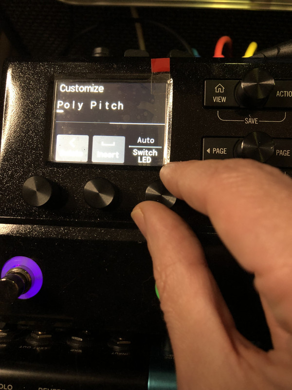

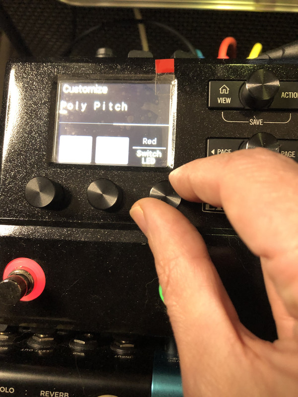

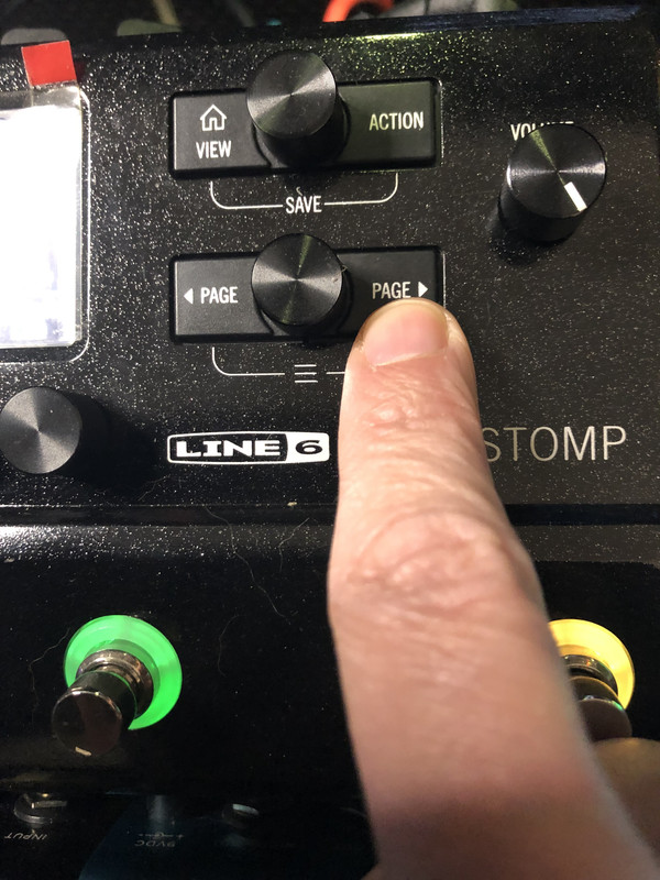

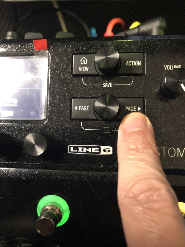

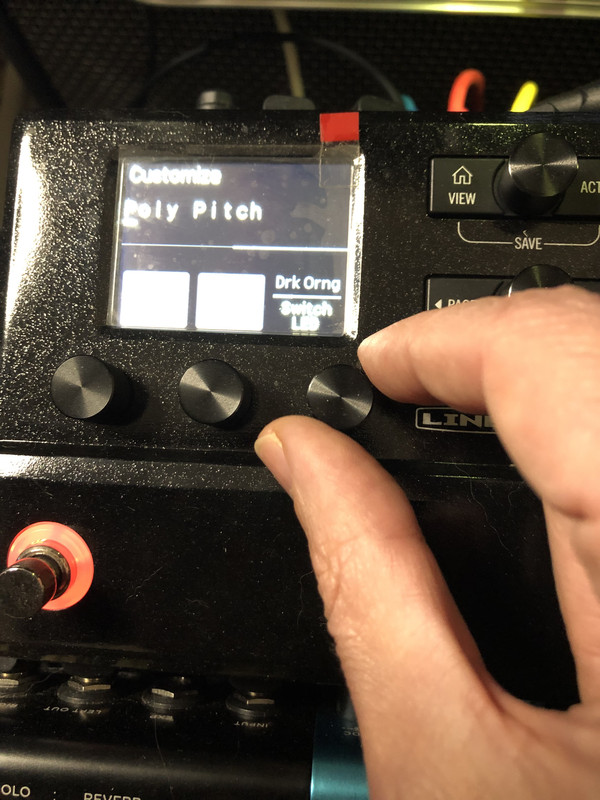

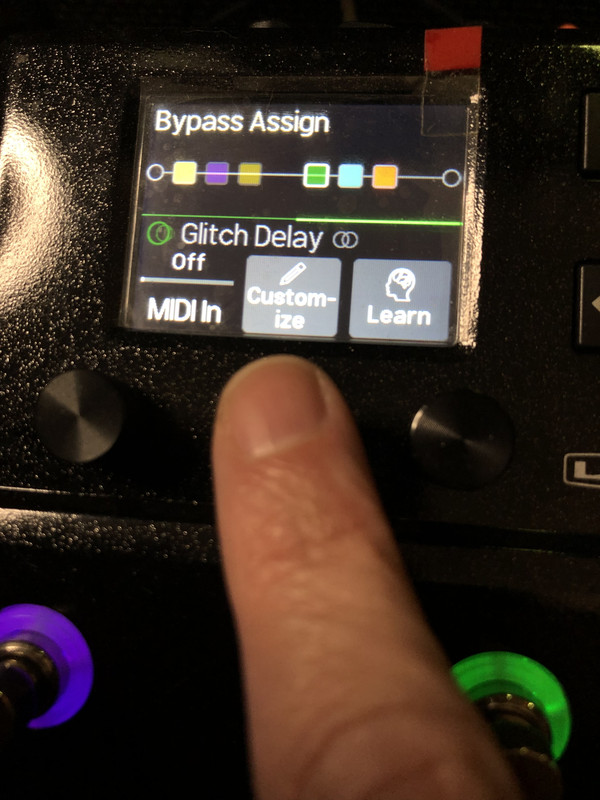

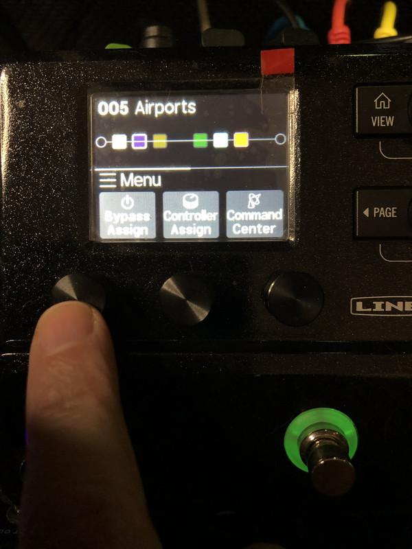

Yes.It's well hidden, but it's there. I did a bunch of shots to visualize the process...
Select Block Bypass you want to change color--->Press PageLeft+PageRight--->Bypass assign--->Page Right--->Customize--->Page Right--->Switch Led (rotary)
