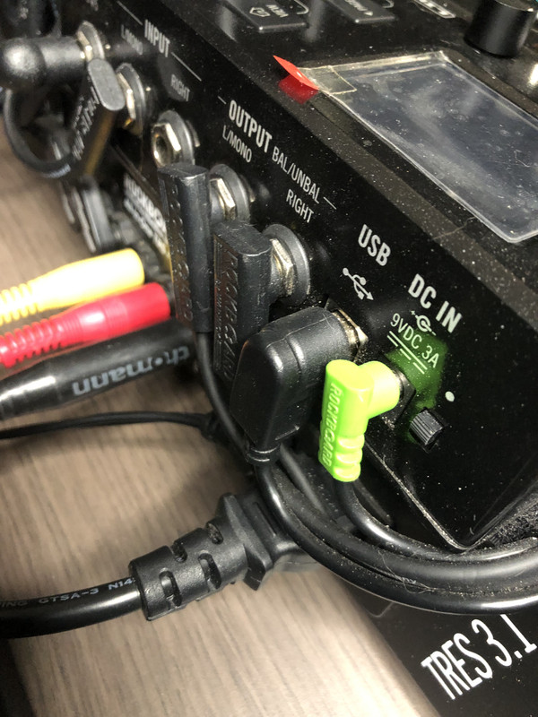

PierM Posted April 16 Share Posted April 16 I do use a USB fixed cable than runs underneath my pedalboard, which has an angled USB B plug to prevent kicking damages. The other side of the cable (USB A) does pop from the other side of the board, ready to be used when needed (when not in use it's just velcroed on the side). Means you plug it once and forget. 2 Quote Link to comment Share on other sites More sharing options...
