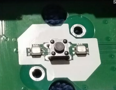

The FS on the Helix (all of them) are NOT real FS, but just mechanical assembly that are pressing against micro tactile switches, so spraying stuff from the outside, is doing nothing other than creating a dust trap.
If you want to properly clean (and check) those tactile switch, you need to open the unit and proceed as you see here (AT YOUR OWN RISK TO DAMAGE THE UNIT);

Well, it's mechanical stuff, so soon or later they are all gonna die. Every switch in the world has a lifespan measured in cycles (clicks).
The average lifespan of those tactile switch is declared to be 100,000 Cycles, which means it will start glitching as you get closer to this number. Of course it also depends how the unit it's being used (and abused) and exposed to contamination (dust, heat, humidity, water etc etc). If you are an heavy stomper and a touring musician, I'd say let's cut this number in half. :)
Usually, when happens to me (not only with Helix but with everything using those tactile switches), I start cleaning them, then if problem come back means it's time to swap them with new parts. (If you're not sure how to do the job, better to have L6 doing that, or any other expert that does know what he's doing).
The way you describe it, looks like it could just be a temporary glitch...maybe some extra dust particles, or a bit of oxidation.
Just wait and see what happens. If it will come back soon, means it's time to clean them all (and see what happens next).

So on my other Helix LT, one foot switch started misbehaving, although nowhere near as bad as on the Helix Floor.  I opened up the Helix and cleaned all tactile switches myself using liquid DeoxIT.  Saved some money and time...
The entire process was very easy, except the plastic tips from the plunger mechanism of several foot switches came off.  I had to use tweezers to put them back in place on top of the spring when re-assembling.  They are tiny and if you are not careful, you can accidentally not assemble the foot switch correctly, or god forbid lose something.
Overall, the whole procedure took me about 25 minutes, and now the foot switches are butter-smooth.  I think people who are not afraid of opening things up can easily perform this maintenance procedure.
Just a word of advice: put all the screws in small containers so you know what goes where... also when in doubt, take a picture of the inside of the Helix before you dissemble/reassemble things.
