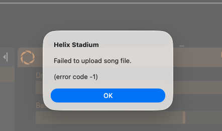

Good morning, I'm trying to use Showcase for the first time by uploading only three WAV tracks with these characteristics (via WIFI)
48 kHz, 24 bit
My new Helix Stadium starts the transfer process but never completes it, giving me this message:
error code -1
Why is this happening? What should I do?
48 kHz, 24 bit
AmplifireMilano,
Can you re-export the stems/wav files with these characteristics ...  44.1kHz @ 32bit?  And it may seem strange but set tracks to mono.  The Stadium conversion process is supposed to create the stereo tracks and adapt the characteristics to the Stadium's needs.  Not sure if that is really what happens since I do not have the native code.  But this is what has worked for me.
