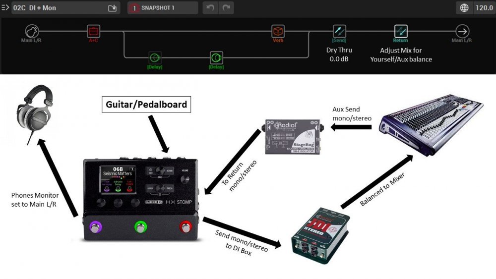

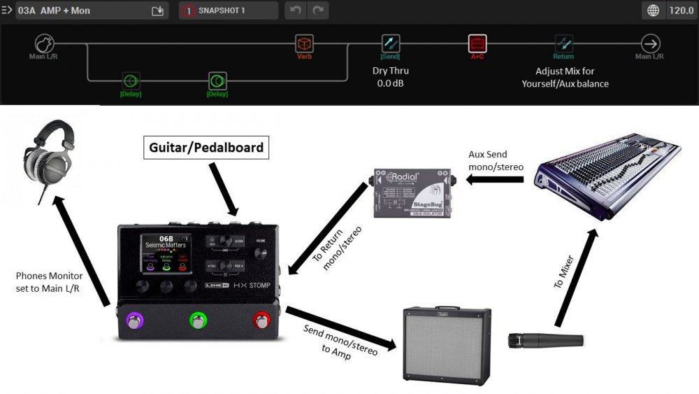

phawinp Posted November 13, 2019 Share Posted November 13, 2019 My first post on this forum! Not sure if anybody have posted about this before... You can use your HX Stomp as a simple in-ear mixer. Direct situation: Amp+Cab > Send (dry thru set to 0.0 dB) > Return (mono or stereo) * Adjust return mix how you want * Set Phones Monitor to Main L/R * You may have to isolate Aux send from mixer before going into the returns. Mine hums like crazy so I put Radial SB-6 which kills the hum! Real amp situation: Send (to real amp) > Amp+Cab > Return * This way you can also monitor your self using HX's amp. * Set Return mix to 100% and remove the amp block if you only want to hear the Aux send from the mixer. * Set Phones Monitor to Main L/R Please share how you use your HX Stomp with inears. Quote Link to comment Share on other sites More sharing options...
