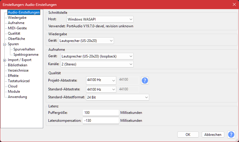

ReverendLove Posted January 14 Share Posted January 14 Make a screenshot of your settings in Audacity and share 'm here. They are in "Edit"->"Settings" and look similar to these Quote Link to comment Share on other sites More sharing options...
