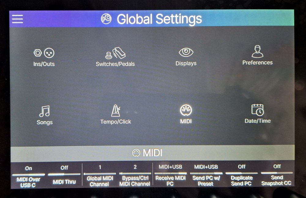

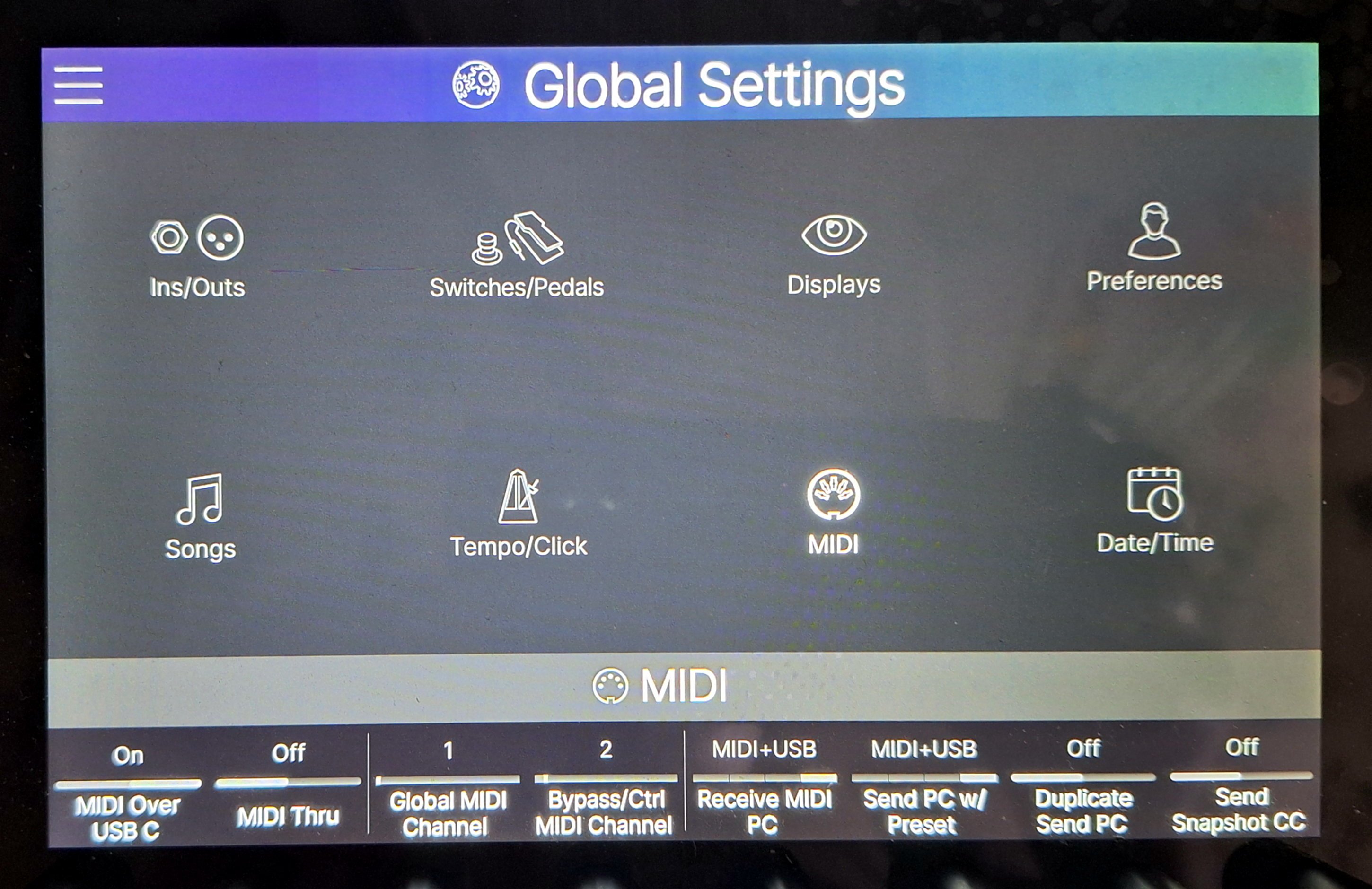

Helix MIDI-Settings are correct (factory settings):
MIDI over USB‑C: On
Global MIDI Channel: 1

I am seeing Helix Stadium responding to MIDI PC and CC from a computer (Mac) over USB-C. In Global Settings > MIDI be sure to have encoders 5 (Receive MIDI PC) and 6 (Send PC w/ Preset) set to "MIDI + USB.
