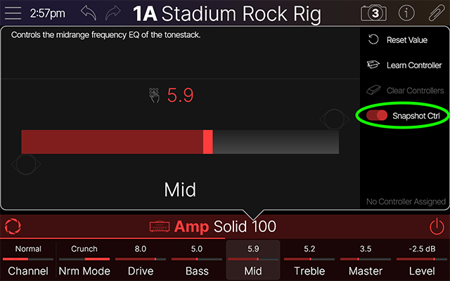

  • 1.2.1—In some cases, recalling snapshots could not correctly recall all block bypass and/or parameter change values—FIXED IMPORTANT! For presets made before 1.2.1, if a specific block bypass or parameter change continues to not recall as expected:
    • Block Bypass: Tap the block and toggle Snapshot Bypass off and then on again (On [default] means the block's bypass state is controlled by snapshots)
    • Parameter Change: Tap the parameter in the inspector and in the sidebar, tap Snapshot Ctrl off and then on again
