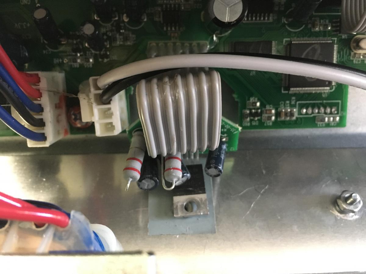

I can't figure out how they're supposed to go back together. The amp works until I screw this part down, then it doesn't work anymore. I'm obviously shorting out somewhere.
Does anyone know the correct order for bolt, spacer, washer, lock washer, and nut?
The spacer (the part next to the bolt) looks like it is plastic (non-conducting?) so its most likely to prevent contact with the rectangular plate and the chassis, so needs to be inserted in the rect plate hole before inserting the bolt.
