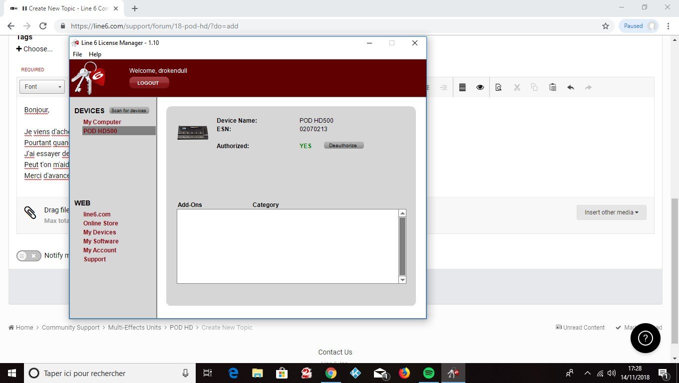

Drokendull Posted November 14, 2018 Share Posted November 14, 2018 Bonjour, Je viens d'achetez un pach hd, j'ai voulu faire la mise à jours mais impossible d'autoriser mon prd hd500. Pourtant quand je clique sur autorised il passe en yes, mais quand je vais voir dans compte il n'apparais pas. J'ai essayer de flasher la mémoire mais ça change rien. Peut t'on m'aider ? Merci d'avance. Quote Link to comment Share on other sites More sharing options...

cage771 Posted November 18, 2018 Share Posted November 18, 2018 I am having the exact same issue. The model packs are not being authorized despite registering my HD500X and jumping through the hoops. Everything (software and firmware) is the latest and greatest. I have uninstalled and reinstalled the software. Still.....no new packs as being authorized. Out of curiosity, what OS are you running? Quote Link to comment Share on other sites More sharing options...

cage771 Posted November 18, 2018 Share Posted November 18, 2018 1 hour ago, hurghanico said: I do not know if you already know it or not, but it is necessary that the latest firmware 2.62 is installed in the POD since it is that version which physically adds the models in the device, the License Manager only serves to authorize and then make visible and usable the new models _______________________________________________________________________________________________________________________________________________________ All about POD HD500/X Thanks! I have verified that I have the latest firmware (2.62) and software. It seems that the software and the server have two ideas of what my POD ESN should be. Although that doesn't make much sense given that I can't authorize my computer(s) either. Im going to give the XP VM setup a chance when I get the time tonight. Quote Link to comment Share on other sites More sharing options...
