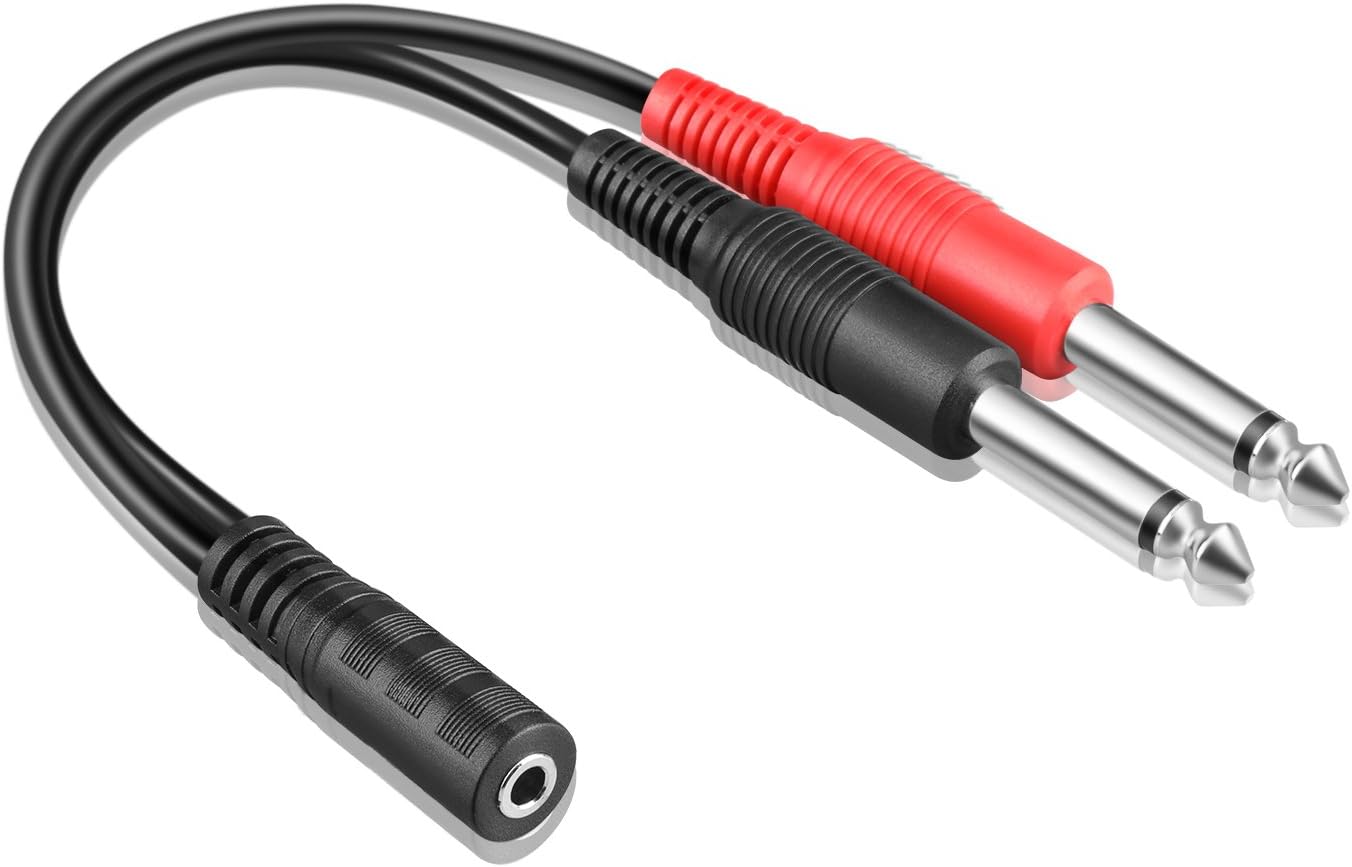

I've opened up the unit and found that the headphone jack is connected by a 4-pin connector. I will look for a replacement cable tomorrow to see if that is the fault. I didn't see any signs of corosion on the circuits but it can't be ruled out. I don't have an extra interface but i tested the R/L on the back and those worked. Would i be able (worst case scenario) to connect some sort of adapter to the R/L outs on the back and get stereo in my headphones? Like two 6.3mm fused into one 3.5mm, or would that be mono?
Yes, it can be done, you need a 3.5mm 1/8 inch TRS Female to 2x 6.35mm 1/4 inch Mono TS Male Y-Splitter Cable.
You should get the same stereo signal you would get from the headphone output, just a little lower in volume, but you have a master volume control that you can set as you need.
(Time ago I compared the signal coming from the standard outputs to the one coming from the headphone output and I noticed that the latter is a little hotter).
