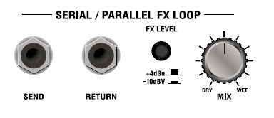

GUITAR IN (NOT PADDED) > TS808 > TIMMY > AC30 (FULL AMP MODEL) > DIGITAL DELAY > PLATE REVERB > MAIN OUT(Instrument Level) > DIRECT INTO MARSHALL JVM410H TUBE AMP SERIAL/ PARALLEL FX RETURN(with -10dBV and mix level to wet 100%)

And this is my amp : Marshall JVM410H(master volume, resonance, presence all at noon, and 0% reverb) with 1960A CAB.
When I play with tube amp, I set master volume of my tube amp at 12 o'clock, and pod go volume knob at 12 o'clock.
