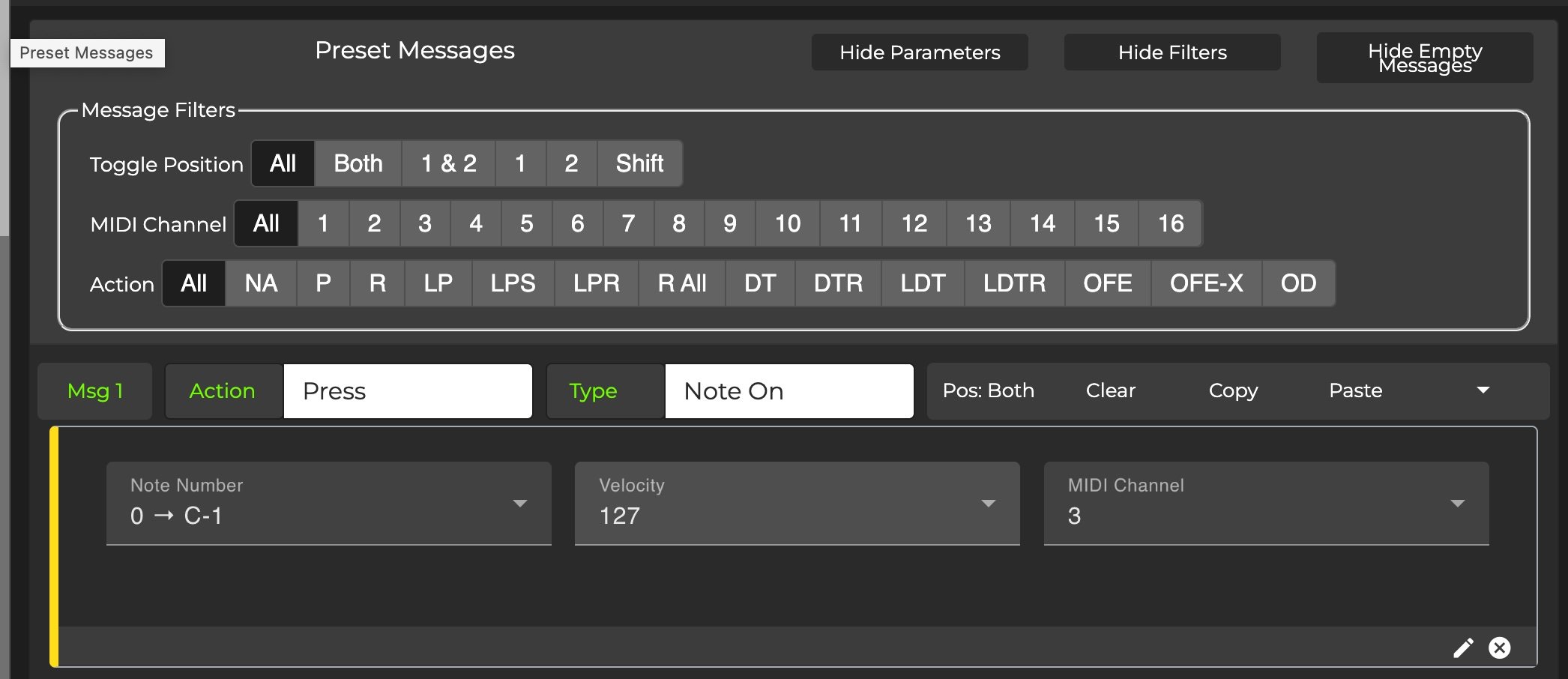

So in my case I needed 4 fs to do the same job as if I am using DL4 as my looper, but I didn't want to lose the beautiful delay sounds that the pedal also has... Right now I integrated my MIDI controller to send note on messages according to ''Owner's manual's Controlling the Looper note on messages'' section.
I'm writing here because I didn't understand which data 1 message I was supposed to send to DL4 for it to understand my note on C - 1 message. In this case it's because Line 6 uses Yamaha's MIDI note spec, and online sources also shows different variations for sending midi too.
I managed to control my looper by setting data 1 parameter starting from ''0'' so it means C-1, and ''2'' is for D-1 and so...
