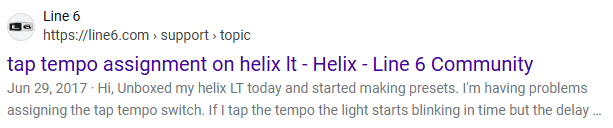

I am a newbie here. Before I am asking, I did a google search and an answer to it from 2017 is no longer available to view.
