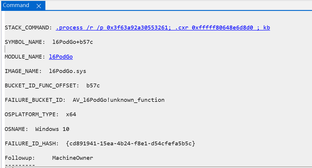

However, weird things happened; I frequently face the BSOD when I plug in the pod and go to my laptop. It usually happens when there are multiple sound outputs at the same time (like Discord, YouTube, Guitar Pro).
I have checked the .dmp files and I found that the line 6 pod go driver (l6PodGo.sys) is causing the crash.
I have checked the .dmp files and I found that the line 6 pod go driver is causing the crash.
I have tried to reinstall the driver or downgrade it by 1 patch, but neither worked.
I have also disabled the memory integrity, but it seems it is not related to this problem.
Does anyone have the same issue? I found that no one is having a problem with the l6PodGo.sys...
