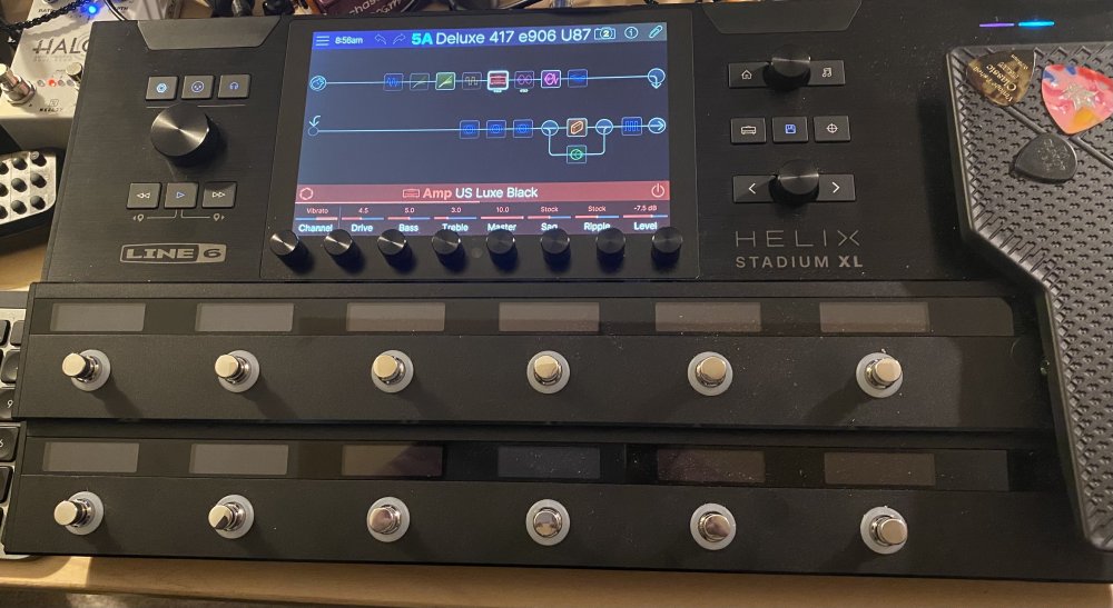

On top of that after shutting down and trying again it might startup but the scribble strips go blank.
Not sure if that's a related issue.
So, I tried resetting to factory defaults again and reinstalling firmware 1.2 and not restore but start all over building presets, importing IRs.
I now boot up ok but the blank scribble strips thing happens. If I fiddle with global settings footswitches the scribble strips reappear.
