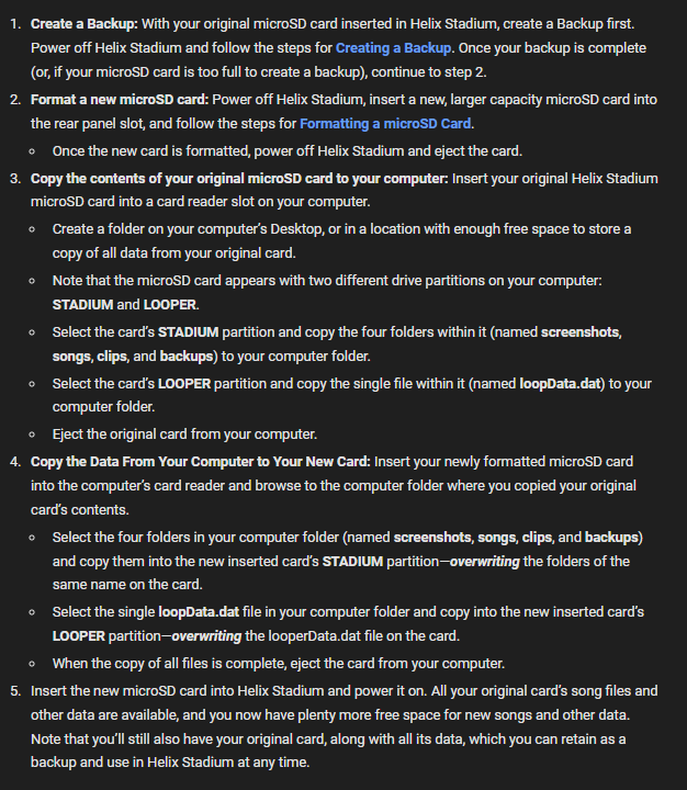

I thought I'd ask ..
How many users are following this exact procedure?  I followed this and discovered the screenshots folder actually had files in it.  I followed the following procedure exactly as outlined without any issue.  The looperData.dat instruction seems to be very important.  Has anyone followed this exact procedure and still had issues?
How many users are following this exact procedure?  I followed this and discovered there is a screenshots folder.  I followed the following procedure exactly as outlined without any issue.  The looperData.dat instruction seems to be very important.  Has anyone followed this exact procedure and still had issues?
I currently have a question to Line 6 support concerning this procedure and will report back in this thread if I get a reply.  It may be nothing but better to be safe than sorry.
