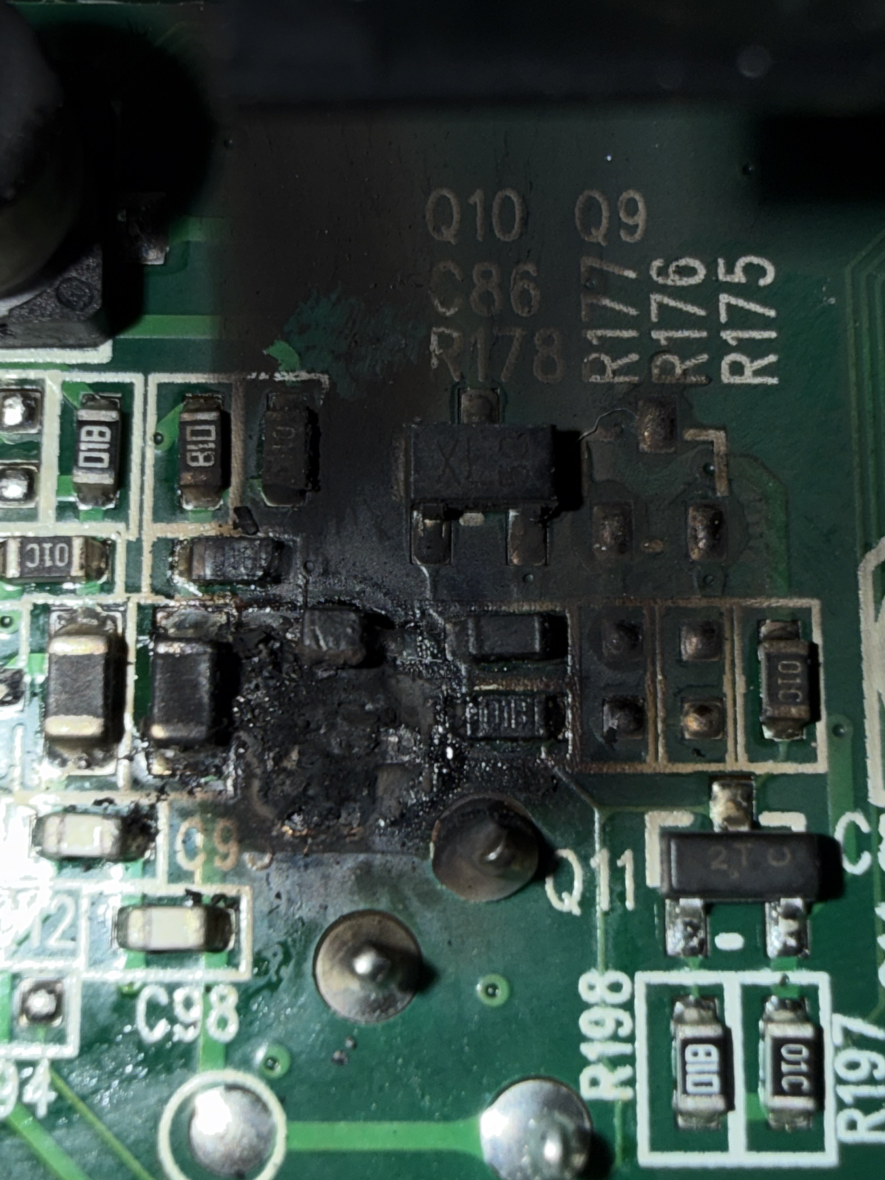

Following up ... I finally got bored enough to tear the thing apart, what I found was quite interesting.
So that is directly opposite where there Left/Mono 1/4" / XLR input is.  Not sure WTF happened there, but there ya have it.  Wish I could point to some action that did it, but I'm at a loss.  The cabinet was working reasonably well just minutes before I did that firmware update.  I'm not suggesting the firmware update did that, I don't see how it could.  Still, if anyone else happens to stumble across a similar issue...
