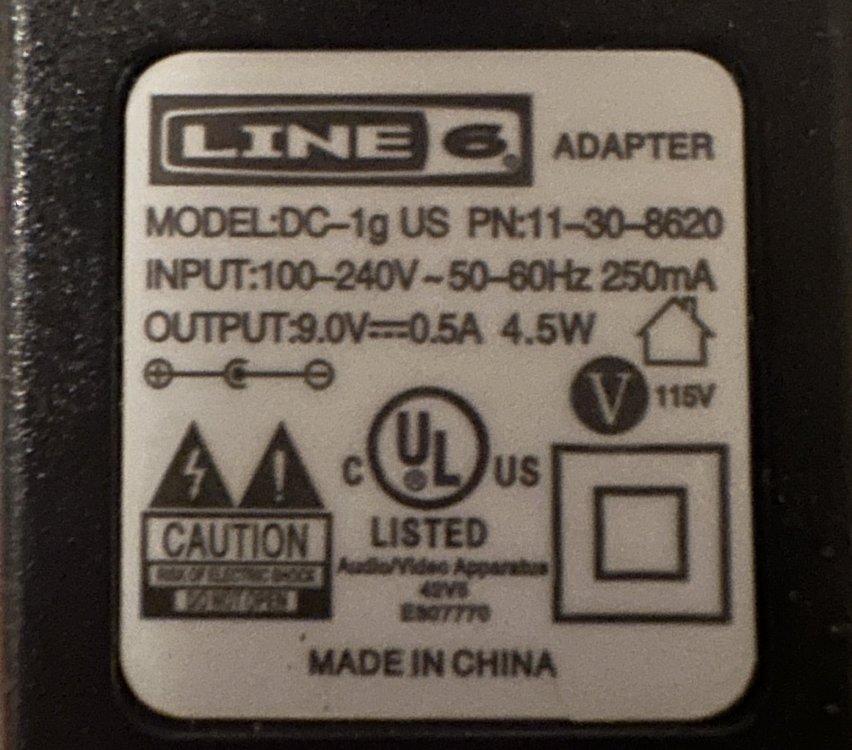

Geuk Posted August 27 Share Posted August 27 I just got a used M5 and it came with a DC-1g. OUTPUT: 9V 0.5A See picture. Quote Link to comment Share on other sites More sharing options...
