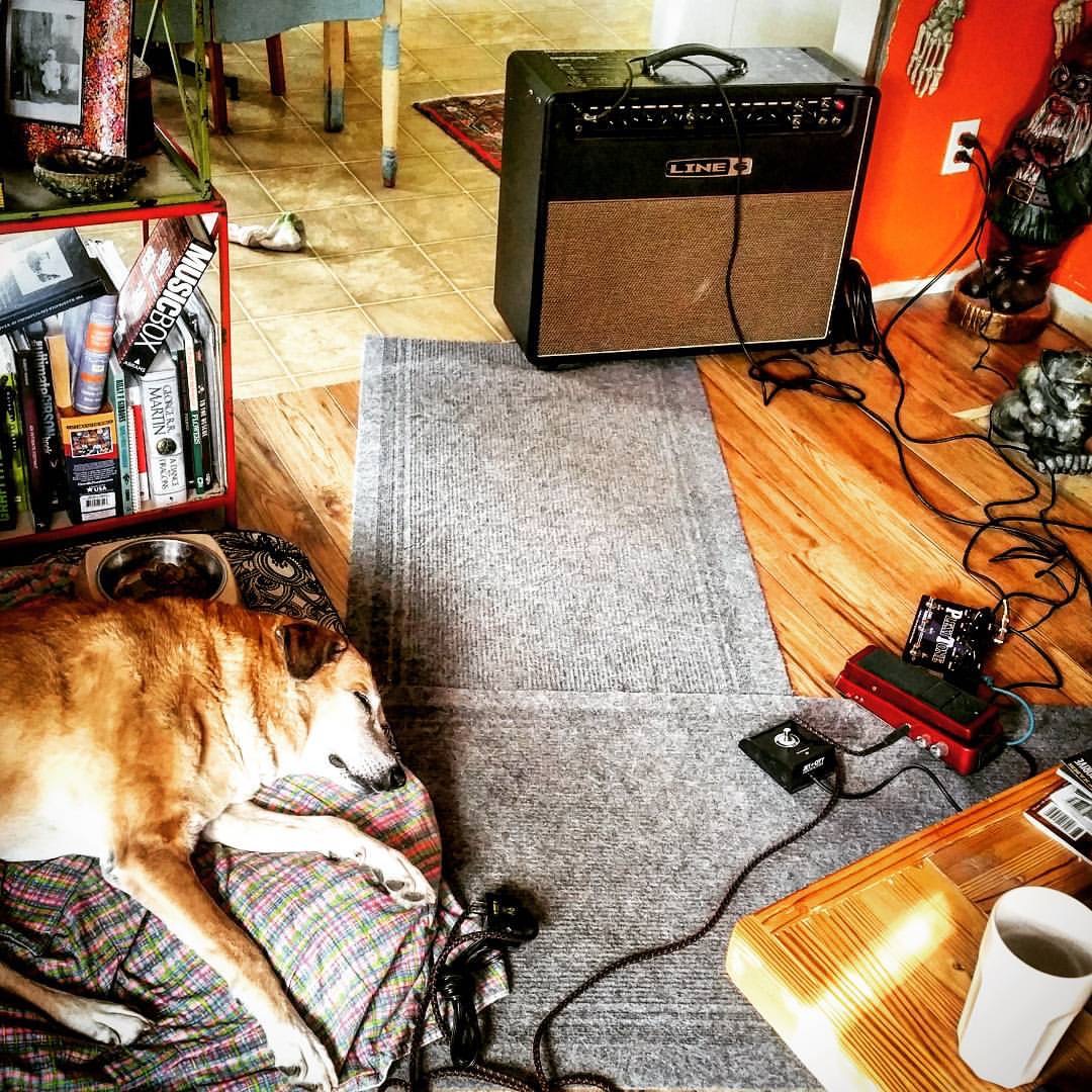

Put the Dt 50 through a good 3 hour rehearsal today, but noticed a harsh upper mid I was not able to dial out. The same upper mid distortion you get with cheaper tube brands.... Anybody have suggestions for tubes for this thing??? Going for Jtm45/100/plexi channel A and an 800/5150 type channel B. Just using amp and a 1 button foot switch.post-2338785-0-11397800-1456900682_thumb.jpeg
