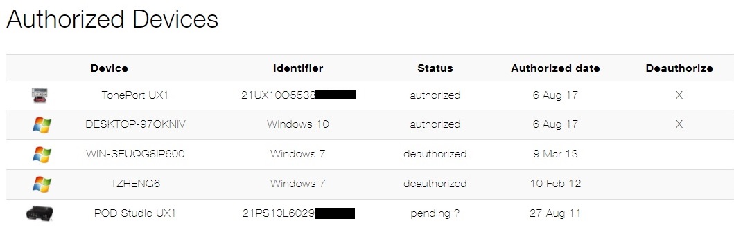

admtzheng Posted August 7, 2017 Share Posted August 7, 2017 I bought a POD studio UX1 6 years ago, but somehow I lost it. Now I got a used toneport UX1, authorized with the my original account/license, and I also authorized my computer, the hardware got reprogrammed for installing the power pack that I purchased years ago.But the POD farm 2.5 is still in trial version(after I logged in with my account in license manager), any idea? Quote Link to comment Share on other sites More sharing options...
Triryche Posted August 7, 2017 Share Posted August 7, 2017 The older red-faced Toneports will only authorize PF 1.12 for free. The exception would be if it was 1st authorized after a certain cutoff date, I do not remember the date, but it is not common. You could try contacting support via phone or ticket to see if there is anything they can do. Quote Link to comment Share on other sites More sharing options...
admtzheng Posted August 8, 2017 Author Share Posted August 8, 2017 The older red-faced Toneports will only authorize PF 1.12 for free. The exception would be if it was 1st authorized after a certain cutoff date, I do not remember the date, but it is not common. You could try contacting support via phone or ticket to see if there is anything they can do. Thank you Triryche, you are right. I uninstalled POD farm 2.59, reinstall a POD farm 1.12, and it worked. Well, 2.59 has more beautiful UI, but I can live with 1.12 as long as it functions the same. Quote Link to comment Share on other sites More sharing options...
