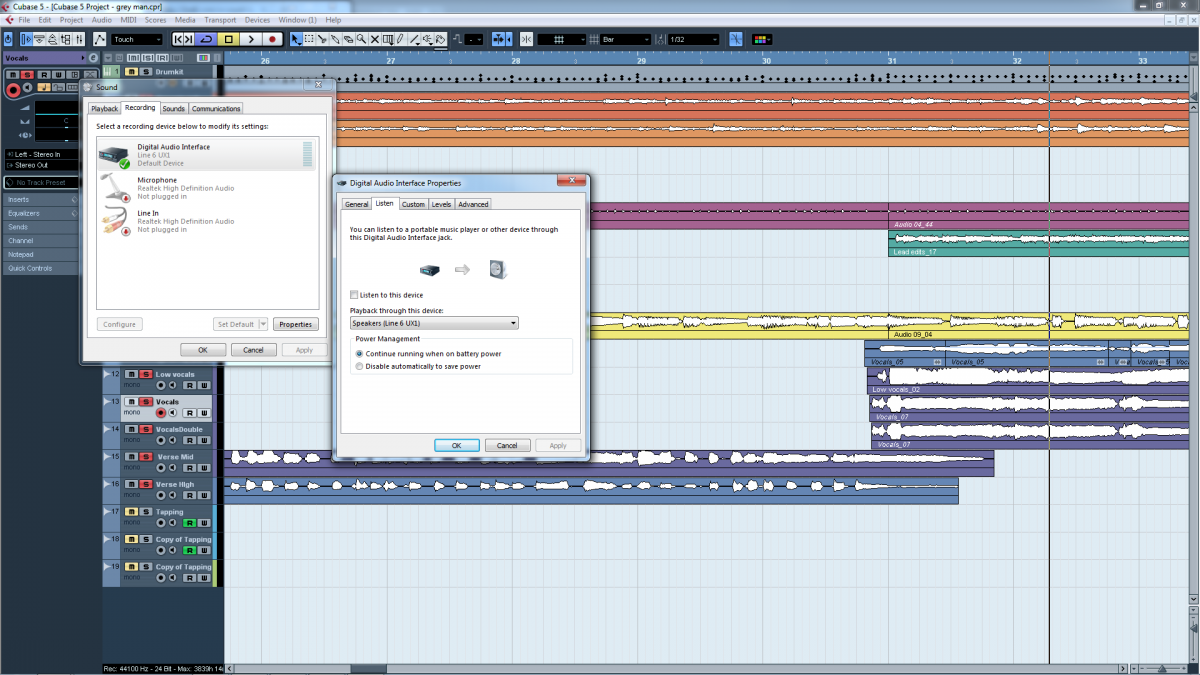

Gaz_Ham Posted September 2, 2017 Share Posted September 2, 2017 so i recently installed my ux1 and podfarm, cutting a long story short. i ended up with hissing/cracking and freezing in cubase 5. i did all the research and followed a lot of advice in old posts, adjusting power settings, sample rates, bit settings and so on, but with no result. i eventually solved this problem by opening control panel, then sound, then recording tab, then double clicking digital audio device(my ux1), then the listen tab and then selecting the speakers(line6 ux1) option in the playback through this device drop down menu. i hopeĀ this helps someone in the future as a possible. please see the attatched picture as a guide 1 Quote Link to comment Share on other sites More sharing options...
