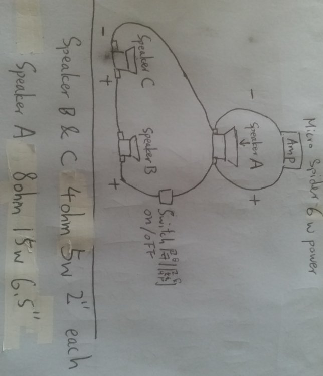

canon5d8 Posted April 23, 2018 Share Posted April 23, 2018 I have a micro spider without warranty. I connect two small speaker (4ohm, 5w, 2inches) on left (B) and right (C) each side, and the original speaker (A) at the middle. So, my micro spider has 3 speakers. See the diagram. Also, I add one swith to control on /off the two small speakers. Now, my micro spider is working fine. The sound is good at the 70% volume. Some bad noise will come If the volume over 70%. I hope my micro spider can be work for 5 years more. Please give me your comment or advice for me. Quote Link to comment Share on other sites More sharing options...
psarkissian Posted April 24, 2018 Share Posted April 24, 2018 You have an impedance mis-match, it wasn't designed for that. It's why you're only getting 70% volume. Quote Link to comment Share on other sites More sharing options...
canon5d8 Posted April 24, 2018 Author Share Posted April 24, 2018 Thanks for reply. I did that because the sound field will be more wide. You know sound come out from left, middle and right. So what should I do to improve it? Change both small speakers to 8 ohm each? So, alll speakers are 8 ohm? Thanks Quote Link to comment Share on other sites More sharing options...
