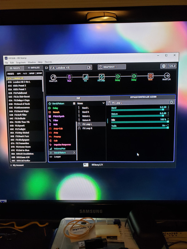

Here's a pic of the send/return view in HX Edit: 20190327-202031.jpg

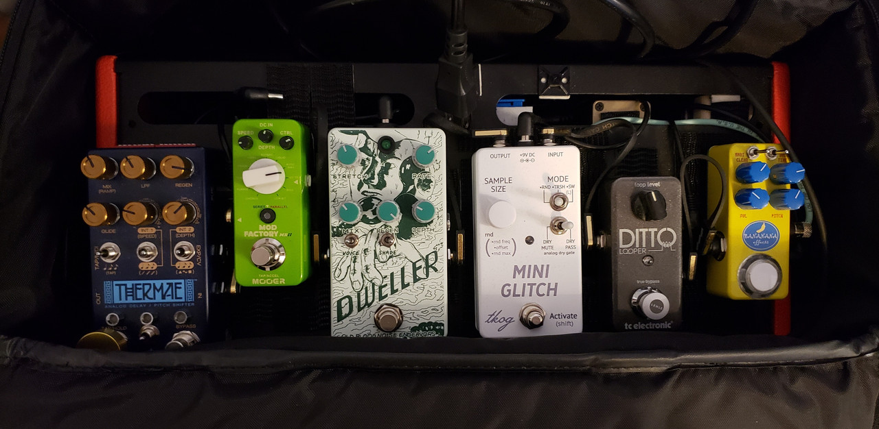

Sure, so here are the two boards:
The first board has two mini pedals underneath, a compressor and a drive always on, and the whole thing is powered by 2 Strymon Ojai's linked.
Signal flow is right to left and the Thermae is the last in the chain.  Into underneath the board to drive then compressor then the top of the board.
The second board is pretty much the same thing except no pedals underneath and signal flow is right to left bottom row then right to left top row.  H9 is last in the chain (there's space for the Thermae which pulls double duty on these boards FWIW).  This board is powered by a Truetone CS7 underneath except for the H9 which has its own power supply.
Again, any time I chain more than two pedals I get the noise.  I pulled a few off the board to test this.
The boards are plugged into the same power strip as the HX Stomp.
Stereo send out of the HX Stomp (in mono) to left mono return of the HX Stomp.
