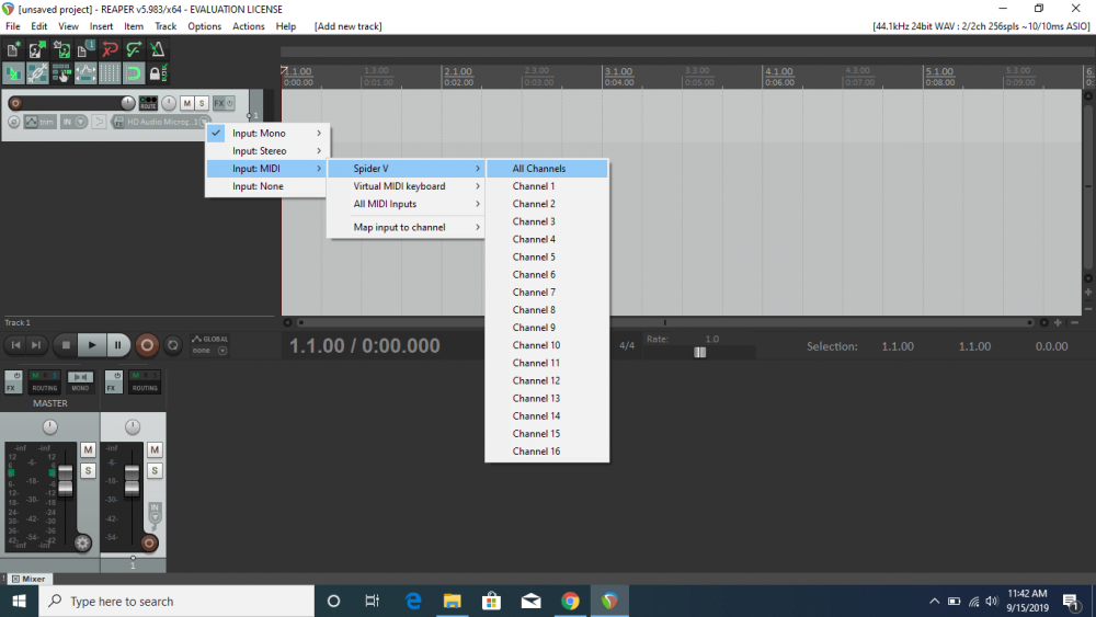

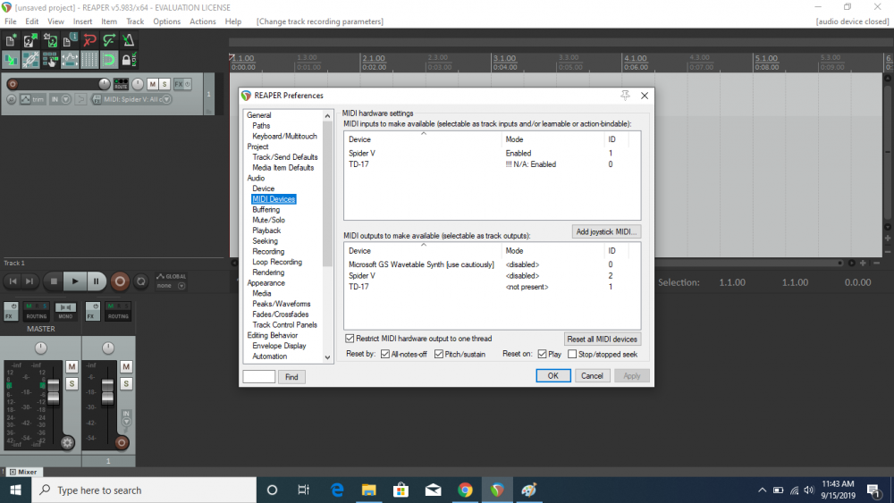

I'm just dipping my toe into the waters of DAW so bear with me if I'm missing something simple.  I'm trying to record my Spider V (with latest firmware) into Reaper.  I have the Line 6 drivers installed, the amp turned on, connected to the PC and Reaper sees it as a MIDI device.  I insert a new track, select Spider V as my input but still nothing.
What am I missing?
Try configuring Reaper to use your Spider amp as an Audio (not MIDI) input device. Select the word Device immediately above the highlighted MIDI Devices in the Reaper Preferences (your screenshot #3). Your Spider amp should show as one of the available audio input devices. Select it. Then after adding a track as you show in your screenshot #1 you will select Input Mono (or stereo if the Spider amp offers it).
Bingo!  That was it.  Thank you!  A couple follow up questions
