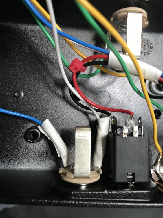

ClarkyCEPU Posted March 22, 2020 Share Posted March 22, 2020 I brought a Mission EP1-L6 for my HX stomp not realising that it didn't have the toe switch for turn effects on and off, I added an after market switch 3 pole 2 position switch with a common terminal in the middle, I bridged one position with a resistor so the circuit goes through the resistor, and the other position with a dead short, and added the extra jack for the Y cable The issue I'm having is I need to press the toe switch twice to turn on an effect and twice to turn in off again, can someone tell me what the problem is and how to fix it cheers. Quote Link to comment Share on other sites More sharing options...
phil_m Posted March 22, 2020 Share Posted March 22, 2020 Do you mean a 3-pole, dual throw switch (3PDT) switch? One thing is that the switch needs to be momentary. Quote Link to comment Share on other sites More sharing options...
