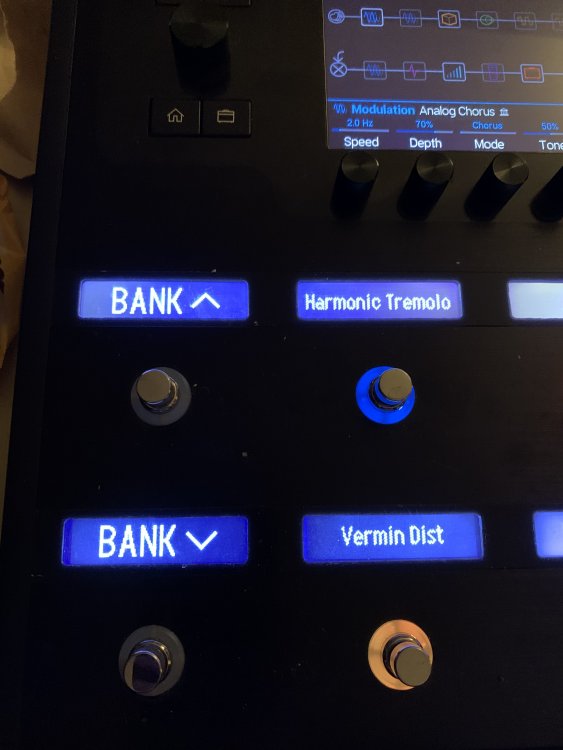

Hello
i have recently bought a Helix and I’m still finding my way. I had the set up I wanted before I updated to 3.00. I had ten pedals doing what I wanted. Since the update I have 8 pedals and two saying bank and I don’t want them. Any idea how I get rid of them please?
thanks
Neil
Your global settings have changed during the update. This particular setting is located under Global Settings>Footswitches>Footswitches>Stomp Mode Switches.
But rather than just changing this one setting, you should do a Restore from Backup to get all your global settings back to how they were prior to the update.
