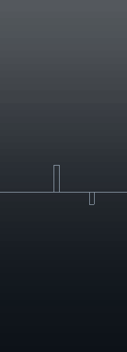

WizkeyandCoffee Posted January 1, 2021 Share Posted January 1, 2021 Hi Forum from Germany, I bougth a new notebook and try some recording with my HX Stomp. It is working, but sometimes in the recording there are strange crackeling sounds. The waveform looks like this: Here is a sample (first few secounds without playing, than some chords, then without playing again) https://www.dropbox.com/s/y76v8boklteqqo0/crackeling.mp3?dl=0 While I'm play i dont hear any crackeling sounds over my headphones (I using the headphone-out on the HX Stomp). I using Cubase 10 LE and installed the newest software (according to HX Edit: HX Stomp 2.81, HX Stomp Driver v1.95) I change the usb-cabel and the usb-port but it is still there. On my old PC the HX Stomp works fine without this strange crackeling. Did anyone have an idea whats wrong? I cant use it like that. Thanks Quote Link to comment Share on other sites More sharing options...
rd2rk Posted January 2, 2021 Share Posted January 2, 2021 What kind of computer are you using? If Windows, what version? i5 with 8gb ram is minimal. I don't know what the 32 bit float setting is about, but HXS is 24 bit. Optimize your computer for audio (google it). At the very least, turn OFF wireless and set your Power Plan to Performance. In Control Panel>System>Advanced>Settings>Visual effects set to Performance. On the Advanced Tab>Performance>Settings set to Background Services. It looks like (based on the RTL latency reported) that you're using 128 samples. You probably wouldn't like 256, but try it. 1 Quote Link to comment Share on other sites More sharing options...
WizkeyandCoffee Posted January 2, 2021 Author Share Posted January 2, 2021 Thanks for your answer. I using a notebbok with Win 10, 16 GB, i7-10750H I turinig the W-LAN off and change in the HX Stomp settings "Default Bit Depth" to 32 (cause I can't change it in Cubase to 24). And it seems like its working. Probably the W-LAN was disturbing something. Quote Link to comment Share on other sites More sharing options...
