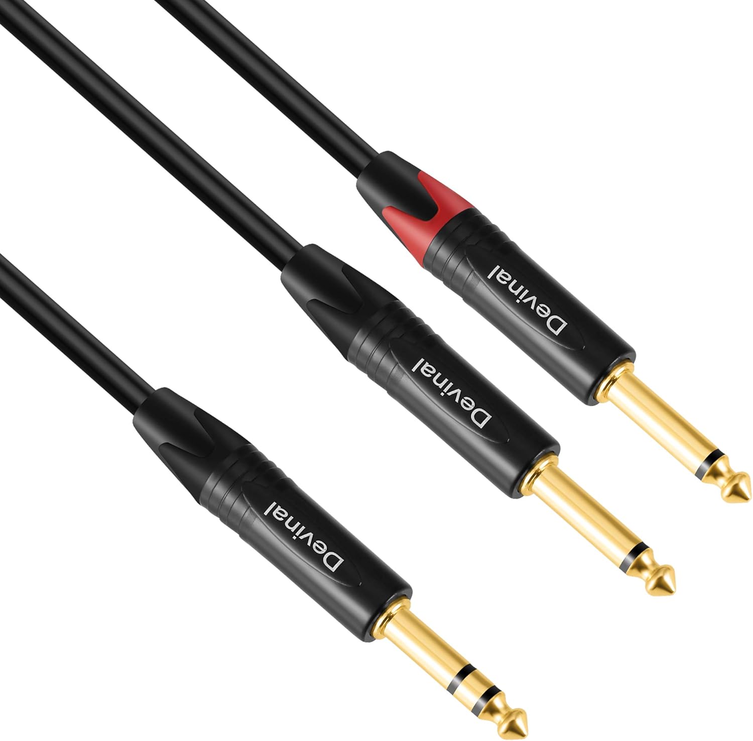

bglendi Posted November 23, 2021 Author Share Posted November 23, 2021 That seems to be another problem, I can't save to any of the four presets. I don't use a lot of the factory installed presets, but when I find one I like, it just won't save. Another problem I was having that may help someone else, I usually always use this amp through the headphones jack, and that too is very inconsistent. What I found is that I have to use a 1/4" TRS cable from the headphones jack, and split it into two channels on my mixers with the cable shown attached. The other end of the cable is a TS connection, and if you do this you will get a nice stereo sound for the presets that are actual stereo. Just make sure you pan the two channels hard left and right in the mixer. Quote Link to comment Share on other sites More sharing options...
fflbrgst Posted November 23, 2021 Share Posted November 23, 2021 Yes, if you want the true FX and stereo sound you need to use the splitter from the headphone output jack. Do you have a FBV MkII pedal to connect the amp to a computer to see if you can update the software? It sounds like the amp has issues that will not be easily resolved without a technician looking at it. Quote Link to comment Share on other sites More sharing options...
