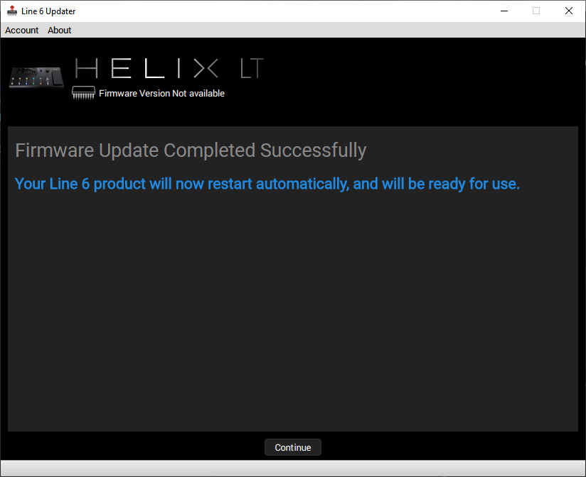

Bren0214 Posted February 14, 2023 Share Posted February 14, 2023 Just tried to update my brand new Helix LT and had the same issue. The instructions in the above link worked thank goodness!! This is the most satisfying thing I've seen in a long time: 1 Quote Link to comment Share on other sites More sharing options...
