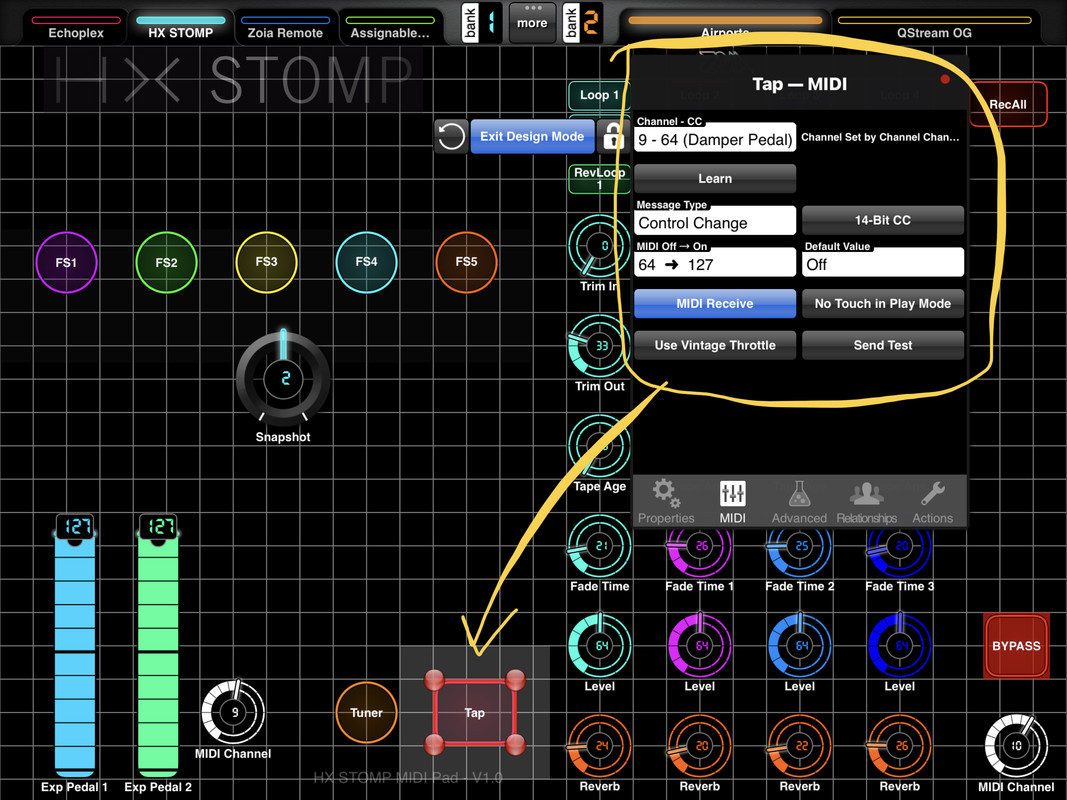

PierM Posted February 2 Share Posted February 2 No idea at this point sorry. For me works fine, whatever app or controller I use. This is from midi designer pro: Quote Link to comment Share on other sites More sharing options...
Barczabass Posted February 2 Author Share Posted February 2 On 2/2/2023 at 8:29 PM, PierM said: No idea at this point sorry. For me works fine, whatever app or controller I use. This is from midi designer pro: Ca How did you setup, the midi in the general settings in HX Stomp, Do you use usb or midi input in the HX Stomp? Quote Link to comment Share on other sites More sharing options...
