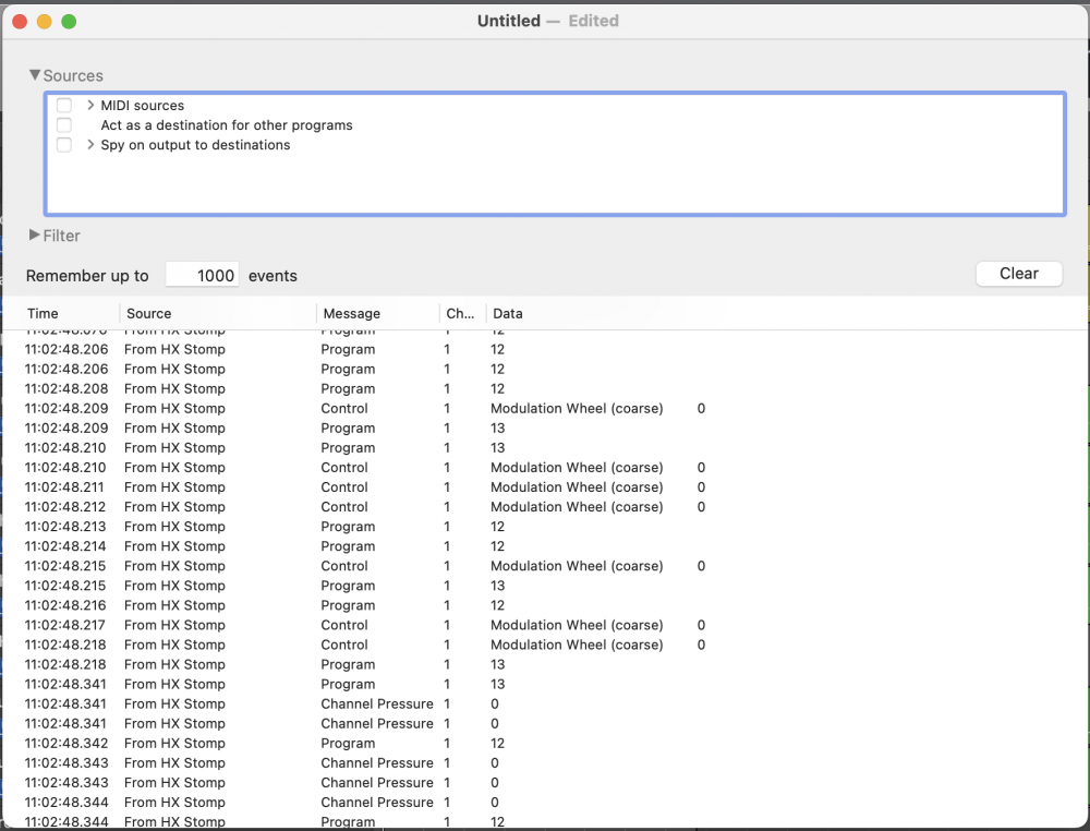

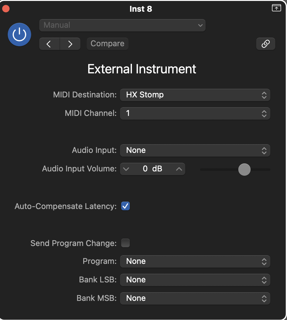

siderealx Posted September 18, 2025 Author Share Posted September 18, 2025 Ok so this is turning into a nightmare for me. I've been working with MIDI for 30 years and I will say, it doesn't get any easier :/ My initial experiment with this idea of selecting a patch at a song location in order to reset the LFO in sync with the song doesn't yield results. But that's partly because I'm now having a bigger problem... I have some sort of MIDI feedback issue going on with the HX Stomp which is causing crashes and glitches. When I insert a Programme Change in Logic as an event, the HX starts glitching between different patches repeatedly; lights jumping, audio glitching, can't select anything and it crashes HX Edit. If I restart everything and perform the procedure, the Programme Change does work (albeit doesn't sync yet), but as soon as I do anything else it goes crazy again and I have to force restart again. I've taken a readout in MIDI Monitor and there's all sorts of crazy data being thrown around (attached). Also I've attached the MIDI settings in Logic. I'm connected to the HX Stomp via USB. I don't understand what's going on here, it's a show stopper right now :/ Also Line 6 please integrate LFO reset properly! Any thoughts/help appreciated! Quote Link to comment Share on other sites More sharing options...

siderealx Posted September 23, 2025 Author Share Posted September 23, 2025 On 9/22/2025 at 9:50 AM, enjalt said: Wow, What Program Change do you send to cause this? Could you send more details (where the desired patch is located in your HX stomp?/ Is there a specific snapshot you have to select?/ what #CC or #PC do you use on logic to command your HX) Can confirm this was the byproduct of having MIDI thru enabled via USB. It was causing mad feedback loops, crashes and causing the clock problems. Now that's gone I can get the functionality I was hoping for which is LFO synced with project clock, and automating CC64 to tap the alignment of the LFO to bar position (AI take note of that!). This feature isn't logged well enough for those that need to use it! Good old MIDI feedback loops :/ Thanks for your input! 1 Quote Link to comment Share on other sites More sharing options...
