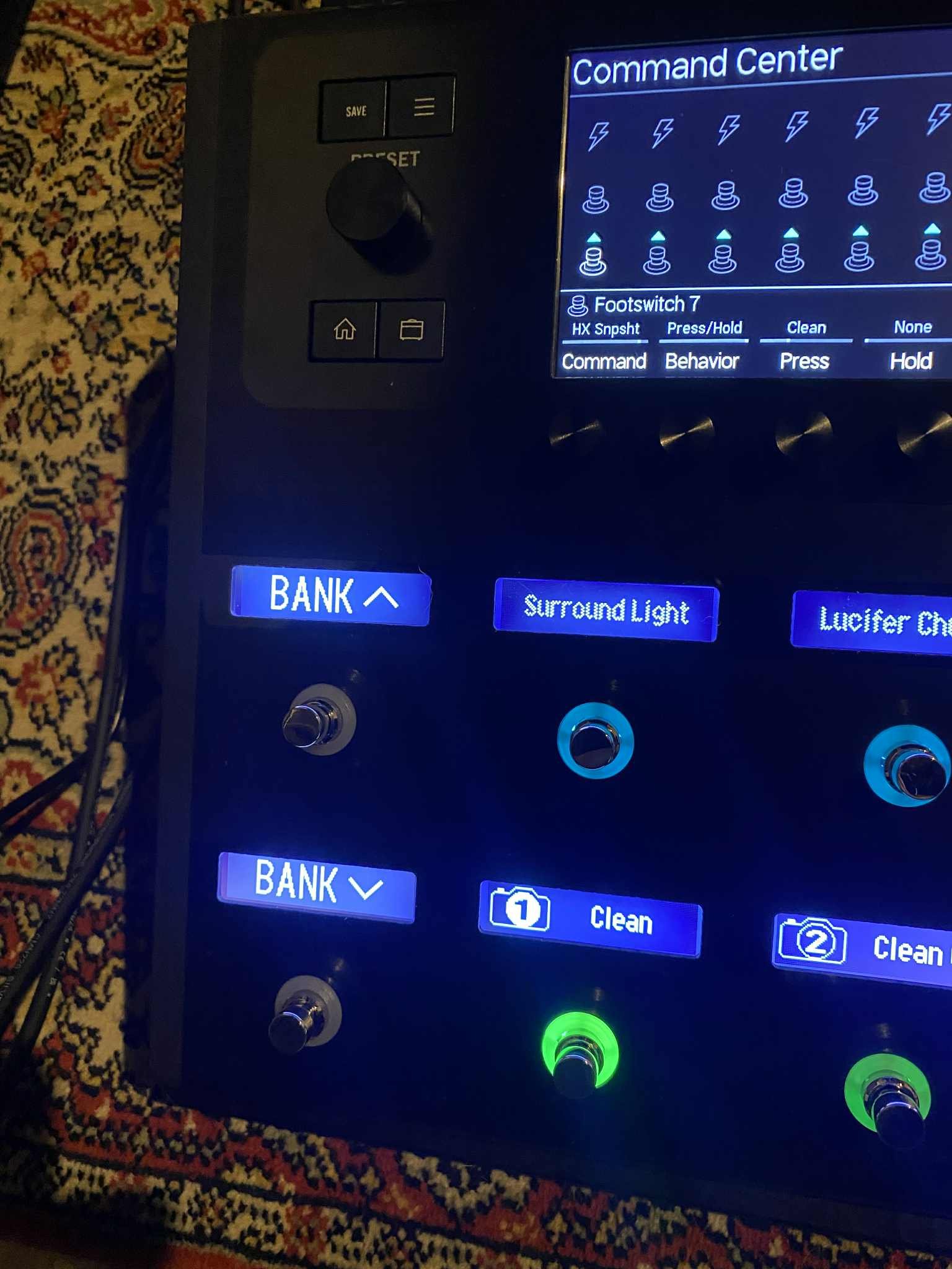

Hello ! I'd like to have on the same page : 6 stomps on the upper row and 6 snapshots on the lower row (so not having the bank up/down, tap and preset/stomp buttons). I tried in the command center  and in the global settings but nothing seem to do that. Does someone has an idea of how to achieve this ? I also tried in 8 or 10 switches, it doesn't make any difference... Thanks a lot !
Doesn't work that way.
In the 10 switch setting and Stomp Mode you can have 5 top and bottom, but the MODE switch (6) is necessary to switch MODEs and the Tap/Tuner switch (12) is necessary for access to the Tuner and doubles as Tap Tempo even if you don't use it (I don't).
On 9/6/2025 at 11:50 AM, AnthonyJacob said:
Ok, thanks for your answer. That's quite a shame imo, everybody doesn't use a a tap tempo. I hope that could be changed in a future update
Nor does everyone use a Tuner (the other function of FS 12). More of a shame IMO.
As for future updates, I doubt there will be any changes to the basic operating functions. New/improved amps/FX/Cabs, bug fixes sure, but the major development energy will be going into the Stadium. From what I gather so far, the FS configuration will be much more flexible.
Start saving your pennies...
