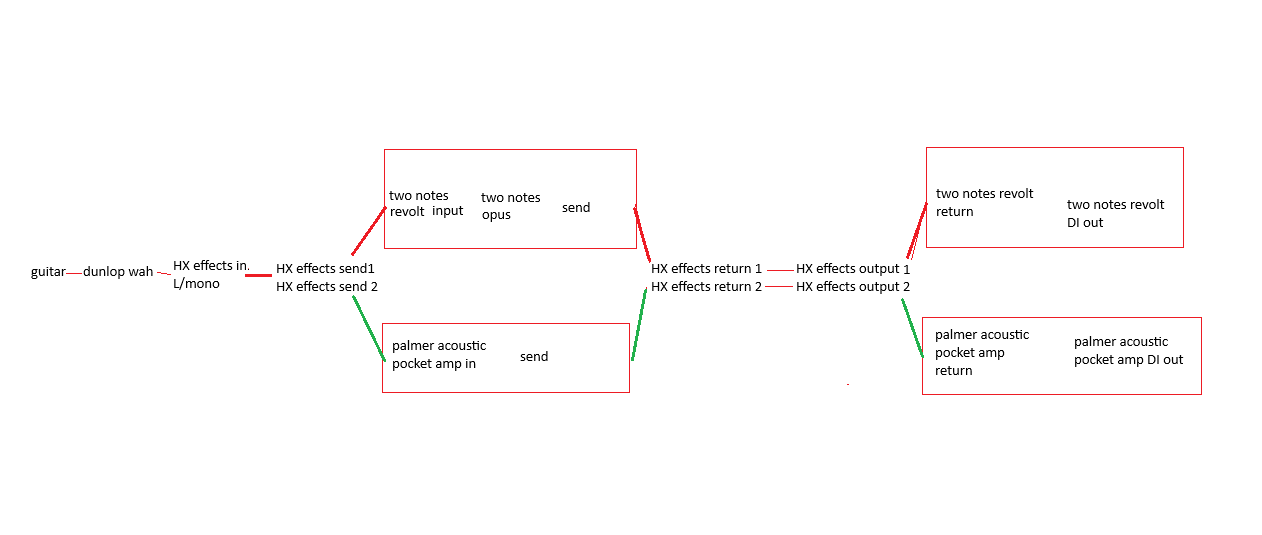

I want to use my HX effects and two preamps with DI.
My usecase:
-I usually play electric guitar
-sometimes I switch to acoustic guitar. I use the same input for that
-I play in a silent band. So everything via DI's to the mixer.
-I have two preamps with DI. 1 for electric guitar, 1 for acoustic guitar. So I use the FX loops on the HX effects and I use the FX loops on the preamps
-I want to use the HX effects for my effects for both pathways. But I don't want the channels mixed up
Setup:
-see the diagram for my hardware and how everything is wired up

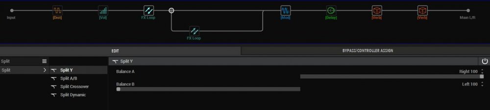

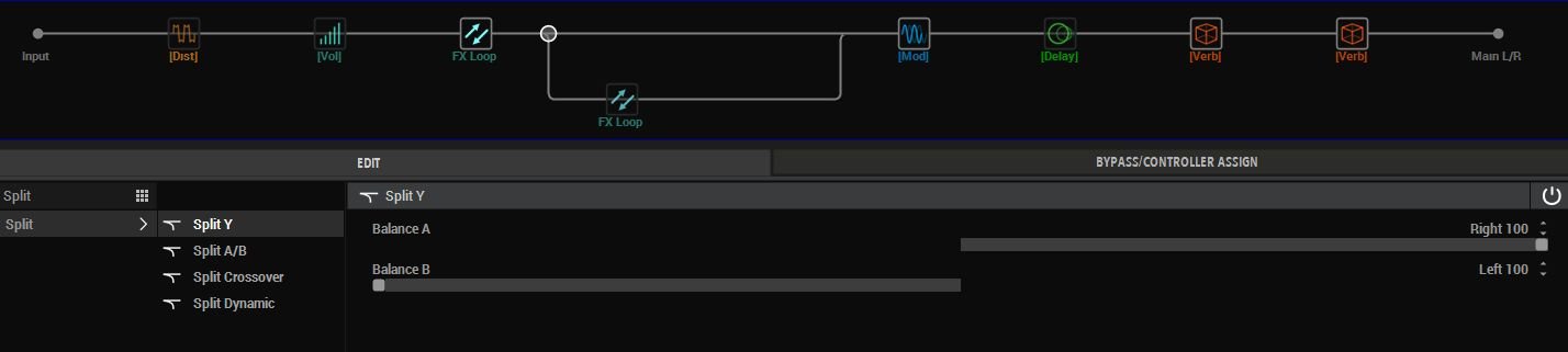

-FX loop 1: before hard panned Y split
-FX loop 2: after split on de right
-if FX loop 1 off & FX loop 2 on: then there is no signal from HX effects output 1 & signal from output 2. Great!
-if FX loop 1 on & FX loop 2 off:  then there is signal from HX effects output 1 & no signal from output 2. Great!
-both off: no signal on both
-both on: signals mixed
So no problem there, just how I want it.
Problem:
I don't understand...
-when I put FX loop 1  after the split (so hard panned to 1), then signal 1 also comes back to HX effects output 2. I Don't understand this.
-same when I remove the split
I have the feeling there should be another way to improve my settings.

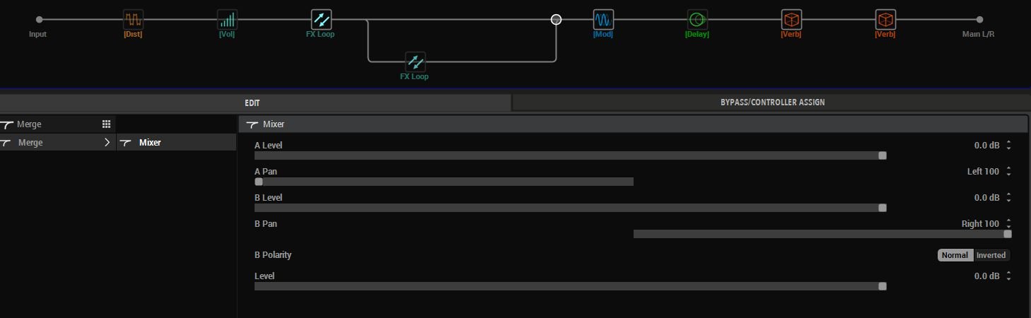

It seems that the problem is that if there is an effect used between the merge/mixer and the main l/r, this effect blends both channels. Doesn't matter if i use a stereo/mono/legacy effect. Even when the channels are fully panned or 1 channel is set on -60dB level.
When I remove or disable the effect, then it works!
So your solution will only work for me when i put my post FX before the merge. So the merge is the last thing before main l/r.
Problem is that every channel now needs it's own reverb instead of sharing the same one. So this doubles the amount of post FX. I use 2 reverbs, 1 delay and 1 chorus. There is not enough space for all these effects

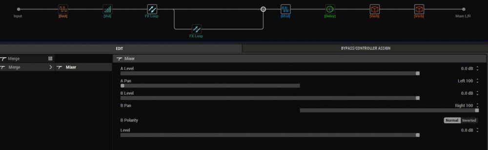

@rd2rkit took some time for me to figure it a bit more out.
The problem was that when the FX loops weren't used they still were bypassed.
It needs this:
-A/B split, route to footswitch with setting min 100% to A and max 100% to B
-same footswitch switches the FX1 and FX2 loops on or off
-mixer A 100% left, B 100% right
This works until... i use an effect after the mixer. When using a mono effect I get equal signals L&R. When I use a stereo effect there is a lower signal created on the other side.
See the attached file
EDIT: I think this works for me. This way the correct preamp is used for electric or acoustic guitar which makes the biggest difference. Both preamps have a DI. Both returns on the preamp get a signal passing it to the DI. Both DI's don't seem to have a distict different sound, sot works for me. I guess even usable for stereo effects.
