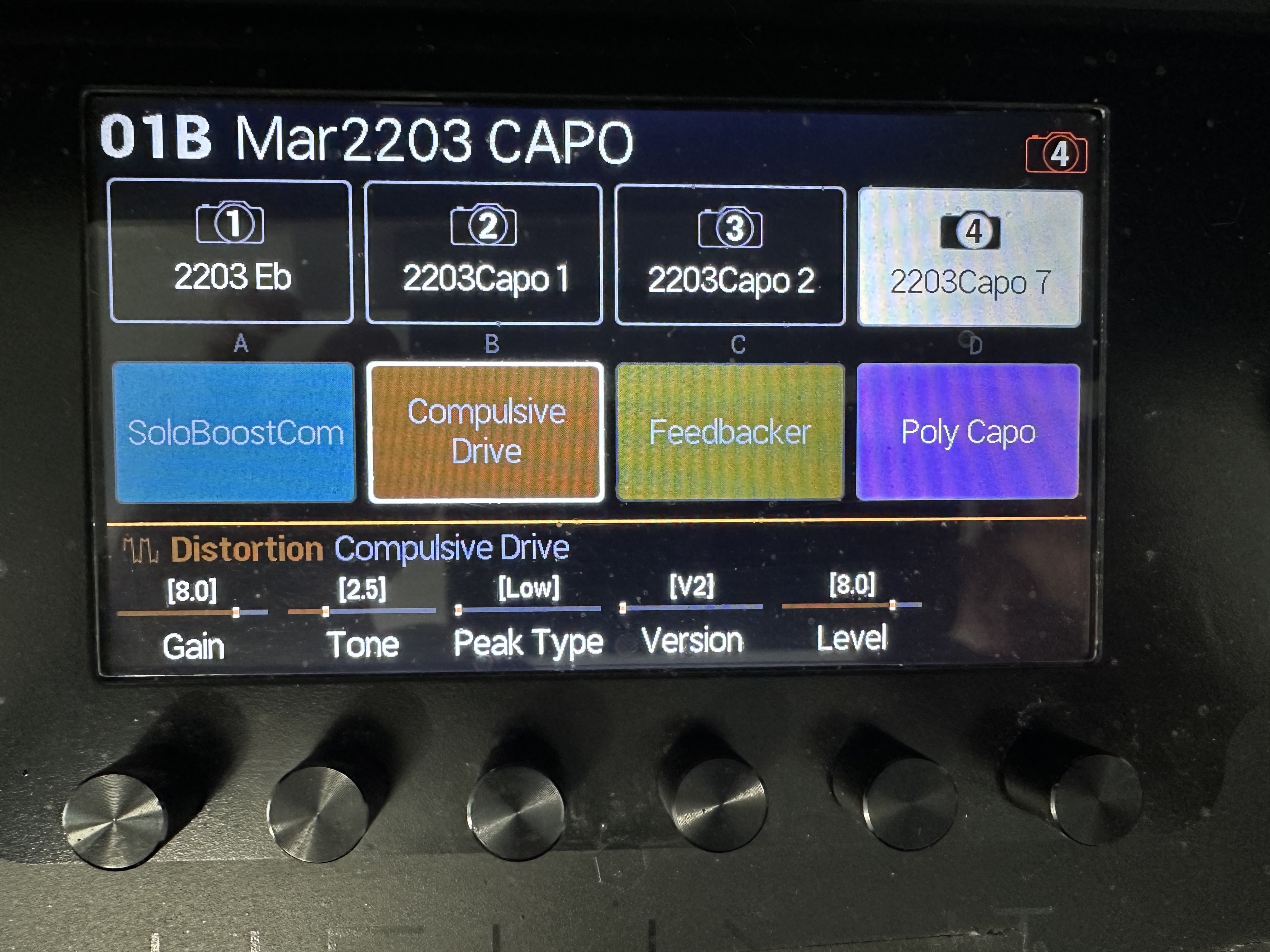

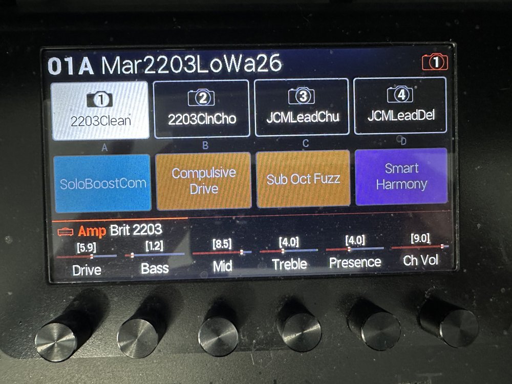

Thanks for the response, it's greatly appreciated. If I decide to get the Catalyst 100, I'll still be using my Helix amps and cabs along with the effects. I've heard some Youtube demos using the Catalyst with and without the cab sims and IR's and I didn't think there was a huge difference thru the amp. I currently run my Helix L and R outs to my PG Power Cab and FOH since I don't use anything in stereo. Replacing the PG with the Catalyst also provides a "backup" in case the Helix fails (it hasn't in ten years of use). I am currently in a cover band but I rarely set up my tone exactly like the record. I play the rhythm and lead parts pretty close but I kick everything up "a notch or two". I can play all of our two - three sets using two presets. I could use one preset if someone in the band didn't insist of playing quite a few songs using capo's and off keys like Eb, Bb, Db, etc. I refuse to use capos! One preset is for standard tuning and the other uses the Helix Virtual Capo.
