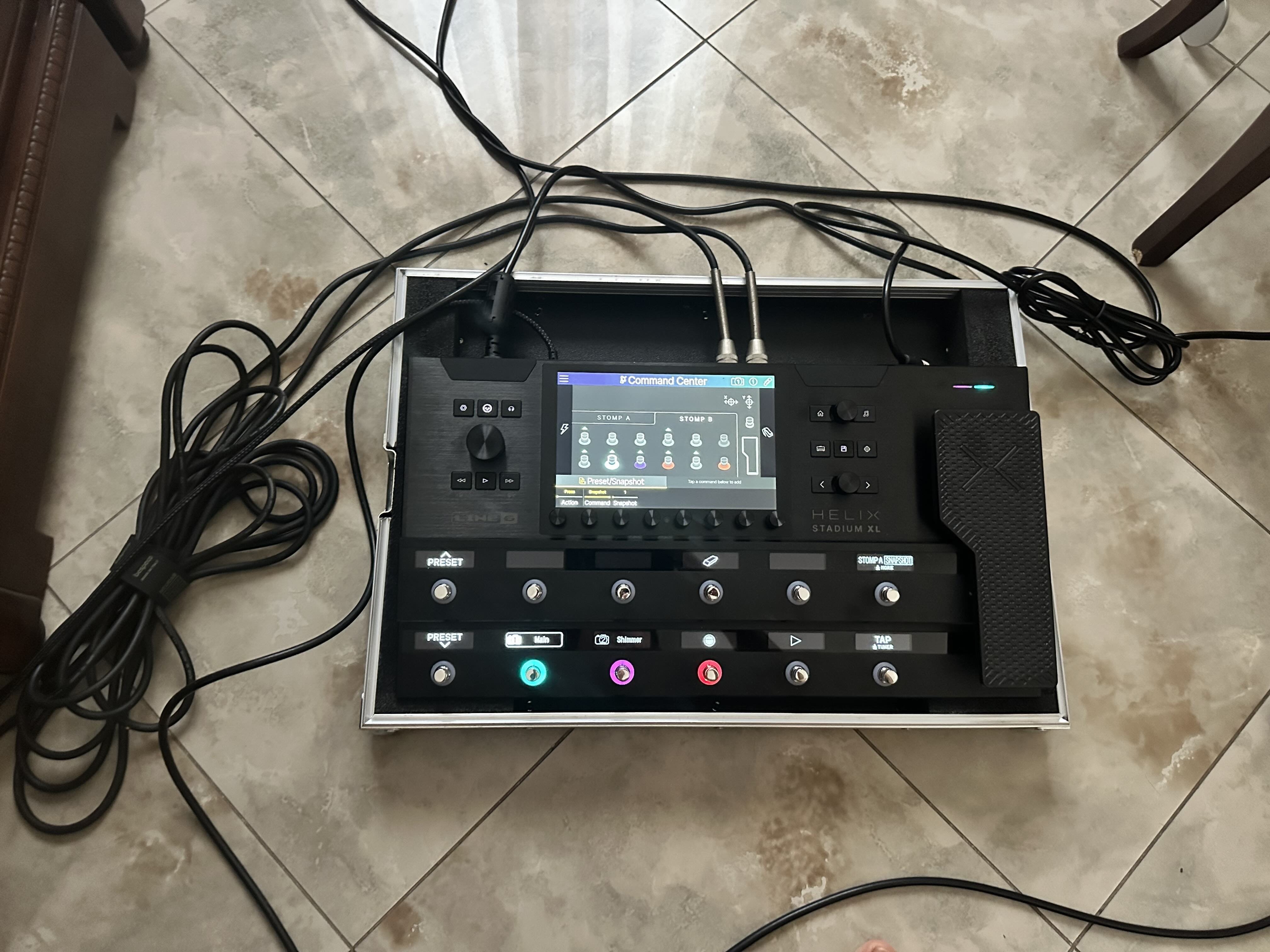

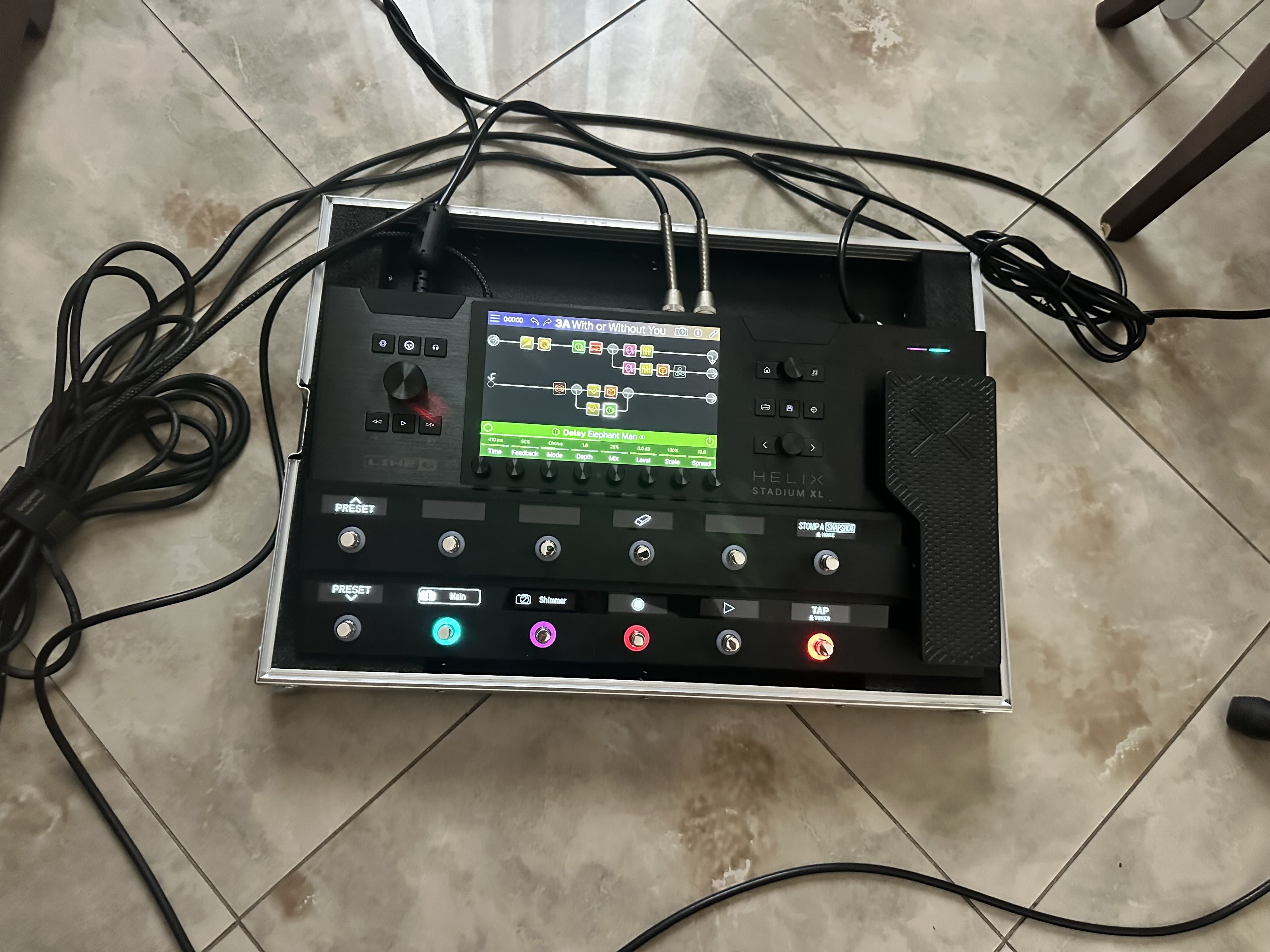

mancogiuseppe Posted Tuesday at 04:05 PM Share Posted Tuesday at 04:05 PM Is the command center supposed to show up on the screen when I custom configure the footswitches for stomp A and then I activate it? Whenever I press a footswitch, the command center shows up on screen. This doesn't happen all the time but randomly I experience it. It's quite annoying... Quote Link to comment Share on other sites More sharing options...
jiml6 Posted Tuesday at 05:37 PM Share Posted Tuesday at 05:37 PM Are you barefoot? If capacitive touch is enabled (which it is by default), a bare toe will kick you into command center. You could try turning off cap-touch (global settings - switches/pedals) or putting on some flip-flops Quote Link to comment Share on other sites More sharing options...
dandesy Posted Wednesday at 01:28 AM Share Posted Wednesday at 01:28 AM This happens to me all the time when i use my fingers on the switches. But never when I play with my properly covered feet. Quote Link to comment Share on other sites More sharing options...
mancogiuseppe Posted Wednesday at 04:42 PM Author Share Posted Wednesday at 04:42 PM Indeed that seems to be my issue. Thanks. Quote Link to comment Share on other sites More sharing options...
