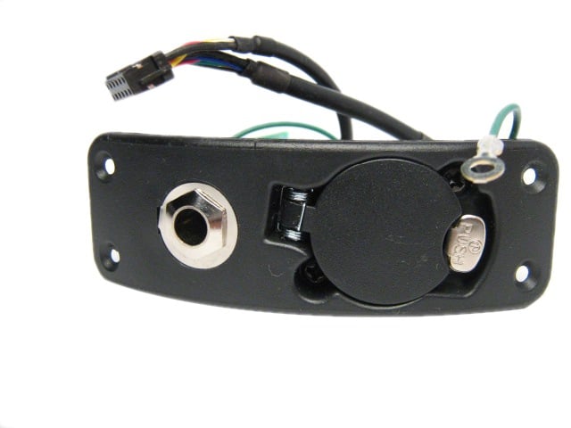

To me, it appears to be a classic "cold solder joint failure" on a PCB mounted 1/4 output jack.
A good tech should be able to reflow the solder on the 1/4" output jack and implement a repair
or replace the JTV output jack assembly
http://www.fullcompass.com/product/429493.html
