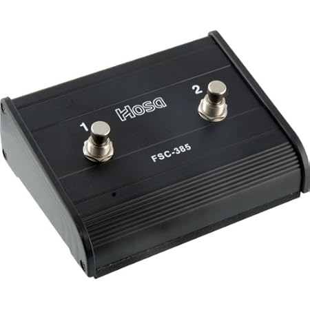

I never got a foot switch for the DT50. I've tried a momentary switch box that I used with my UX2. It's momentary that uses a mono cable and if you pressed the switch and held it the DT switched channels but if you let off the switch it changed back. So I would say a mono latching is whats needed. I was just using the HD500 via L6 link or just going into the front of the DT for the most part.
I think this one is the one I would need for the DT50. I think the DT25 is different in that I thought I read somewhere that the reverb could be also be controlled, not sure though. The DT50 can only switch channels as far as I know.
This one's mono latching.
http://hosatech.com/product/fsc-384/
Footswitch Guitar-style, Single-latching
The FSC-384 footswitch by Hosa Technology is an incredible value. A sturdy, extruded aluminum chassis makes it strong enough to withstand the rigors of the road. Simply connect a 1/4 in TS cable (sold separately) from the footswitch to the unit you wish to control, and you’re set.
A latching footswitch is designed for guitar amp channel switching, signal processor on-off switching, and similar electronic device functions.
Consult your owner’s manual to ensure compatibility.
Connector: 1/4 in TS
