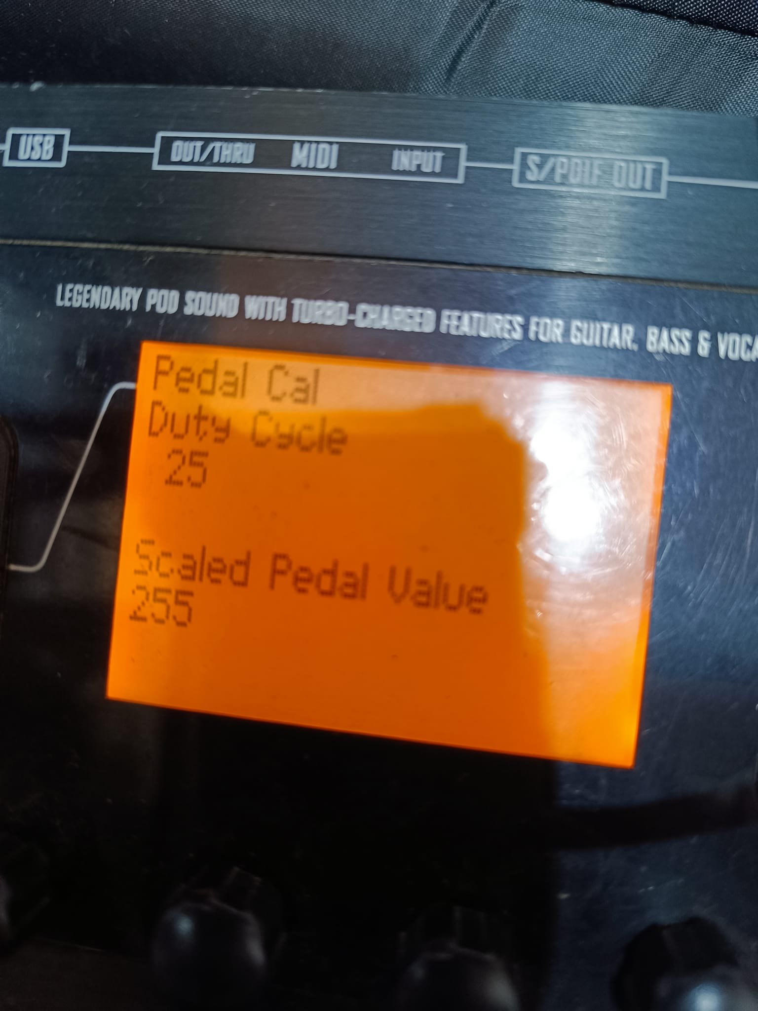

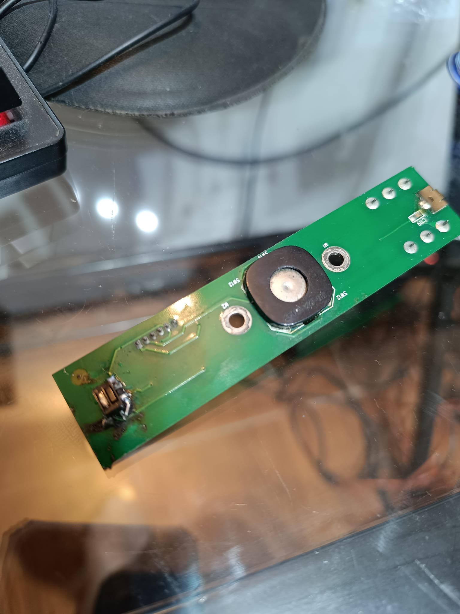

It could be that the pedal's board is shot. Which I do believe a replacement is not a bank breaker but until then:
Q: How do I calibrate the Expression pedal on the POD X3 Live?
A: 1. Go to test mode by holding down 'Right' on the directional pad when you power up.
2. Highlight Pedal Cal.
3. Press the INPUTS button.
4. Set the pedal to the heel position.
5. Press the A footswitch to get data on pwm duty cycles.
6. Set the pedal to the toe position.
7. Press the B footswitch to get data on pwm duty cycles.
8. Press the C footswitch for automatic selection of the best duty cycle.
9. Move the pedal to get smooth 0-255 Scaled Values.
10. Press the D footswitch to save the settings.
