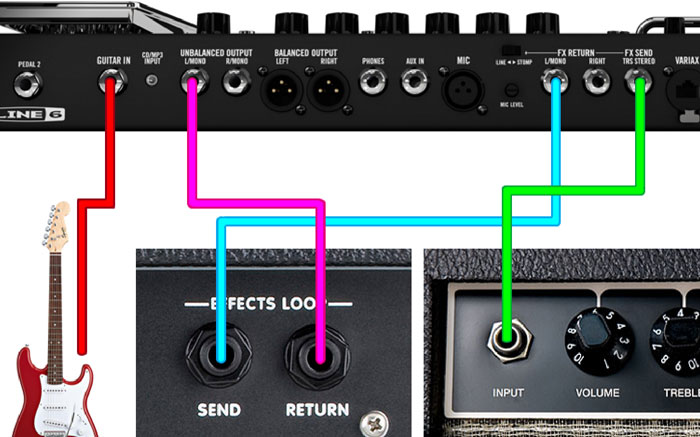

MarcintheCloud Posted February 20, 2016 Share Posted February 20, 2016 Hi folks, I bought an Orange tube amp to have something 'tubey' to mess around with. The dry sound is great but would like to add some delay/reverb and the option to put a tube screamer model in the front. My goal is to 'preserve' the Orange's pre amp so that it's gain, volume, and tone shape knobs all work. I currently have my firehawk wired to the Orange using the 4 cable method: http://guitargearfinder.com/wp-content/uploads/2015/03/4-cable-method-hd500x.jpg My issue is that now it is as if the pre amp is completely bypassed on the Orange (the volum, gain, tone shape etc is ignored). As a result, it's like the power amp is on full volume and from the Firehawk, I had to turn down the guitar/master output down to basically nothing. On the firehawk side, I have the 'amp' and 'cab' models to none. Is there something else I need to do? Or is there a better way to wire the firehawk to the amp? Again, my goal is to keep the knobs on the Orange amp working and just add a bit of delay, reverb, and boost in the front. Thanks for any help/suggestions! Best, Marc Quote Link to comment Share on other sites More sharing options...

jdebiase Posted February 20, 2016 Share Posted February 20, 2016 You can also try turning off the FH amps so you are only using the Orange pre amp and cab. Then use any of the sweet fx in the FH and tweak away! Quote Link to comment Share on other sites More sharing options...
MarcintheCloud Posted February 20, 2016 Author Share Posted February 20, 2016 Thanks! I do have the amps on the Firehawk turned off. Is it normal for the oranges amp controls to be completely disabled then? It doesn't sound like I'm getting the oranges pre amp as the gain and tone shaping knobs are all bypassed still. Quote Link to comment Share on other sites More sharing options...
jdebiase Posted February 20, 2016 Share Posted February 20, 2016 But did you turn on the FX loop on the remote app? The Firehawk sees the orange as a device in the fx loop chain. Also, if you are running the newest firmware, you should move the FX loop (like a device) in front of the "amp" in the app's signal chain and make sure it is turned on. Play with those amp out and line out little buttons near the jacks on back of the FH. You may need to change your output. Jim Quote Link to comment Share on other sites More sharing options...
urbanspaceblast Posted February 21, 2016 Share Posted February 21, 2016 Thanks! I do have the amps on the Firehawk turned off. Is it normal for the oranges amp controls to be completely disabled then? It doesn't sound like I'm getting the oranges pre amp as the gain and tone shaping knobs are all bypassed still. I have the OR15, all the controls are before the FX return in the circuit. So it would appear you are routed straight into the power amp. As above, activate the FX loop and adjust the loop levels in the app. Quote Link to comment Share on other sites More sharing options...
MarcintheCloud Posted February 21, 2016 Author Share Posted February 21, 2016 Ha! That was it thanks guys. I've oddly never noticed the 'FX loop' button in the chain and turning that on and adjusting the mix did the trick. Now I'm back to dialing in sounds. It's amazing how much each pedal has an effect on the sound. Quote Link to comment Share on other sites More sharing options...
