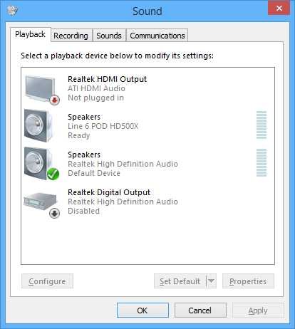

matonanjin Posted July 9, 2018 Share Posted July 9, 2018 If I go into Control Panel->Sound Playback and Recording does not show my POD HD 500X as one of my choices. However, in Control Panel "Line 6 Audio-Midi devices" does show up. I'm plugged into my computer by USB. when I turn on my POD I do get the beep that Windows knows it's there. Anyone any ideas on how I can get Windows to play with my POD so I can play through it into my computer? Edited to add: I do have the latest driver, btw, v4.2.7.6 Quote Link to comment Share on other sites More sharing options...

matonanjin Posted July 12, 2018 Author Share Posted July 12, 2018 7 hours ago, spaceatl said: The configuration you are trying to do using the onboard card for playback is cumbersome and generally makes overdubbing quite problematic...I would suggest you get a little 1/8" TRS to 1/4" TRS adapter and plug your speakers into the headphone jack of the POD. Let's be very clear. I am not trying to do any configuration. I don't have any planned configuration! lol I'm just trying to get this d#$%ned thing so it will play through my speakers. So in that Windows box above I tell it to use the "Speakers Line 6..etc"? After I get the adapter and plug my speakers into it, of course. And then at some point I'm going to be able to tell my DAW (Reaper) to use the POD? Once again, Thank You. Due to medical appointments and some other things going on it will be a day or two before I can go get that adapter. If you don't hear back it's not because I gave up or lost interest! Unless I find one of those adapters laying around. Quote Link to comment Share on other sites More sharing options...

matonanjin Posted July 13, 2018 Author Share Posted July 13, 2018 Woo hoo!!!!!!!!!!!!!!!!!!!!!!!!!!!!!!! If I tell my computer to use "Speakers Line 6 POD" for playback and then play something. (I chose Debbie Davies' new album btw. ) The music comes through my headphones plugged into my POD! Now to get that adapter so I can plug my speakers into the POD. Quote Link to comment Share on other sites More sharing options...
