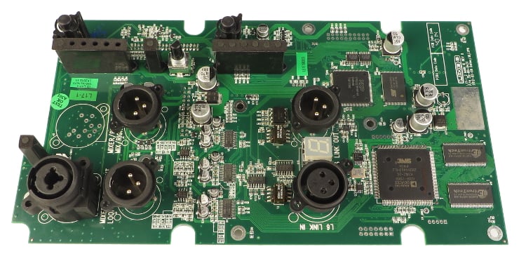

-          So; first up; we contacted Full Compass, and bought the replacement L6link board, and installed it ourselves. This didn’t fix the problem…
-          So then we took it to the local authorized service center that Line6 referenced us to, and they ordered another of the L6link board. (not sure why? at Line6 direction?)
-          This board also exhibited identical incorrect behavior as the one we had already bought. identifies in M20d as L3s sub, low frequency sound only / no treble.
-          The most recent attempt for Line6 to troubleshoot this had my tech move a small jumper from old board to new.
-           It didn’t help. We had already done that from the broken board to the board we bought from Full Compass.

This is the replacement L6 Link main board that we bought one of, and then the service center bought another..(why? at the direction of Line6?)
Line 6 has yet to answer as to why they couldn't figure out how to direct their authorized service center how to install and use the perfectly fine card we bought.
Or why they had the authorized service center purchase a second Line6 link card; which they exhibited the same problems without first properly diagnosing the ACTUAL ISSUES.
