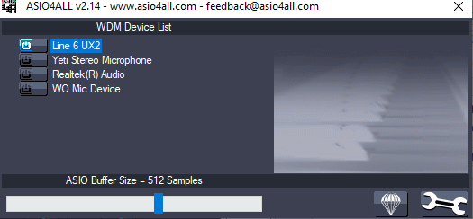

Audacity does not support ASIO drivers out of the box due to Steinberg licensing. You can compile Audacity to support ASIO (google Audacity ASIO), but the easier option  IMHO  is try a DAW that supports ASIO out of the box. Reaper is free to try and cheap to buy.

Download the Line6 ASIO driver and select that in Reaper.
In Reaper the last input should be 4 if you want to capture L/R dry and L/R wet (to 2 separate tracks).
In the mixer view of PF or the Line6 AudioMIDI control panel you need to configure your sends for wet and/or dry.
ASIO4ALL is fairly useless these days expect as a last resort.
