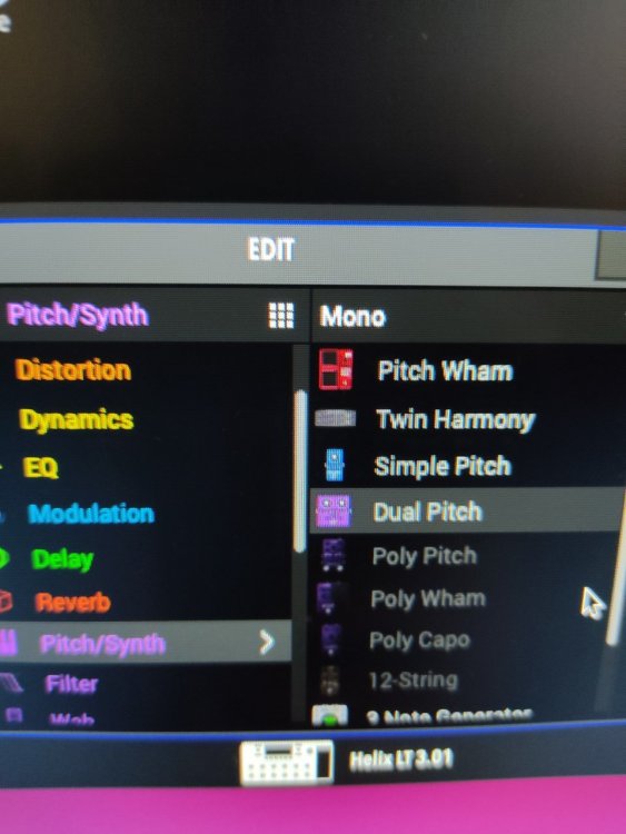

Hi, i have installed the new version 3.0.1 but there are many new effects that i can NOT use its. The old ones are on white and works ok but the new ones are darker in unavailable.
Poly PITCH AND OTHERS ARE NOT AVAILABLE TO USE : CHECK THE PIC
Thanks
That means there is not sufficient DSP available to add these very DSP-heavy FX. To maximize your DSP make sure you are using both Paths 1 and 2. If you’re already doing that you will need to remove (not just turn off) other FX blocks in the preset until you see that these are  not greyed out.
