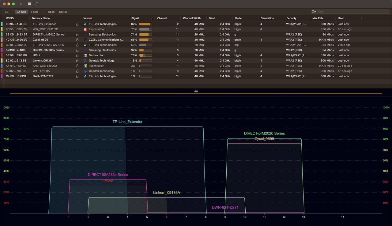

PierM Posted March 5, 2023 Share Posted March 5, 2023 On 3/5/2023 at 5:29 PM, Iofhealing said: Hi PierM, Thank you for answering my questions. I was wondering if you could elaborate on your answers for me. !). What do you mean by setting the router WiFi signal power to minimum (enough for a single floor average house)? Do you mean that I should run the router's WiFi at 2.4 ghz as opposed to 5.) ghz? Or do you mean that I should do something different on this one? 2). And what is the point of using the G10s systems if there are so many things that can interfere with them in the area? Are they going to hold up decently? And the funny thing is that they (the G10S's) worked just fine at all of the places that we took them to while using them with our Mackie ProFX16 mixer. And they worked just fine even with the Soundcraft Ui16 digital mixer for the first program that we took them out on. It was just at this one program that we went to last that I couldn't get hardly any of them to function with a descent signal. Now granted, I had the router right on top of the Soundcraft Ui16 mixer and right next to the G10s receivers. But do you think that the G10S's should work on a consistent basis. I hate to think that the $1200 plus we spent on our 5 G10S systems was a waste. Thanks, Andy 1) I mean setting your router power output for the 2.4Ghz at lowest possible level. Check your router manual to find that option, which is available to the majority of brands and models. If your netgear is close to the Soundcraft, setting its output power to minimum, will assure an optimal signal level for the Mixer, but it will drop at a shorter distance for everything else around, which means less WiFi pollution on the stage. 2) WiFI pollution is a problem for any Wireless system which works in the 2.4Ghz, and in exactly same Channels used by any other WiFi device. The G10S offer 11 Channels, and Auto function, which will scan for less busy channel and connect to it. This happens only when Transmitter is connected to its base. It's important that you check every single base before to unplug the transmitters, to check if the left bar is showing a single solid Red Led. Two Red Leds, means the channel used by this station is a little busy. Three solid reds means this channel is very busy and will cause signal drops. If you have a WiFi scanner (even an app is fine), you could check the less busy Channel@2.4Ghz, and assign these channels to your receivers manually. Do not assign the same channel to all yours receivers, but try to give them a free channel each, better if there is another channel in the middle. Like for example; if Receiver 1 is on Channel 4, set Receiver 2 on Channel 6 or Channel 2 (if these are not too busy by other SSID). Let me say that you took a risky path buying five units, as these systems are very picky with Channel traffic, Noise, and Bandwidth overlapping. For busy stages you need pro grade UHF units, not really WiFi 2.4Ghz consumer stuff. :) Should they work on a consistent basis? No. It will always depend on the local WiFi pollution, and in the actual Channel assignment. You can improve that consistency by reducing pollution (like the power output trick on the router), shutting down WiFi on everything you don't need to use, and checking Channel quality with the 3 left leds on the receivers, and also with a WiFi scanner running on a Mac, a PC, or a Tablet/Smartphone. In my experience with these units, you want 1 solid red led when Transmitter is plugged, and 3 green leds when Transmitter is in use, with an acceptable blinking of the first green led on the top. As soon as you see the green leds dropping and wobbling to much, you know this channel is being too busy, or too noisy, and it will probably cause audio drops. Remember that, when you turn on your receivers, you want ALL transmitters, to be plugged in their receivers, and you need to wait for them to scan for the best channel. Since you have 5 of them, they will fight a bit so, again, keep an eye on the left leds and manual assign their channels if needed. Another trick could be to let receivers finding channels one at time, to reduce bandwidth overlapping between them at minimum. Let me post a screenshot of a WiFi scanner application (in this case my house), to show you how does look a very typical situation these days. You see how many device are present in the area (these are either routers, printers and anything else generating a SSID), and the channels they are using. You can also see how each device does take more than a channel, because of the wide bandwidth. You wouldn't want your G10s connecting to those busy channels, so having the scanner it will help you solving the most problematic stages or rooms (when Auto channel won't work as expected)... Quote Link to comment Share on other sites More sharing options...
