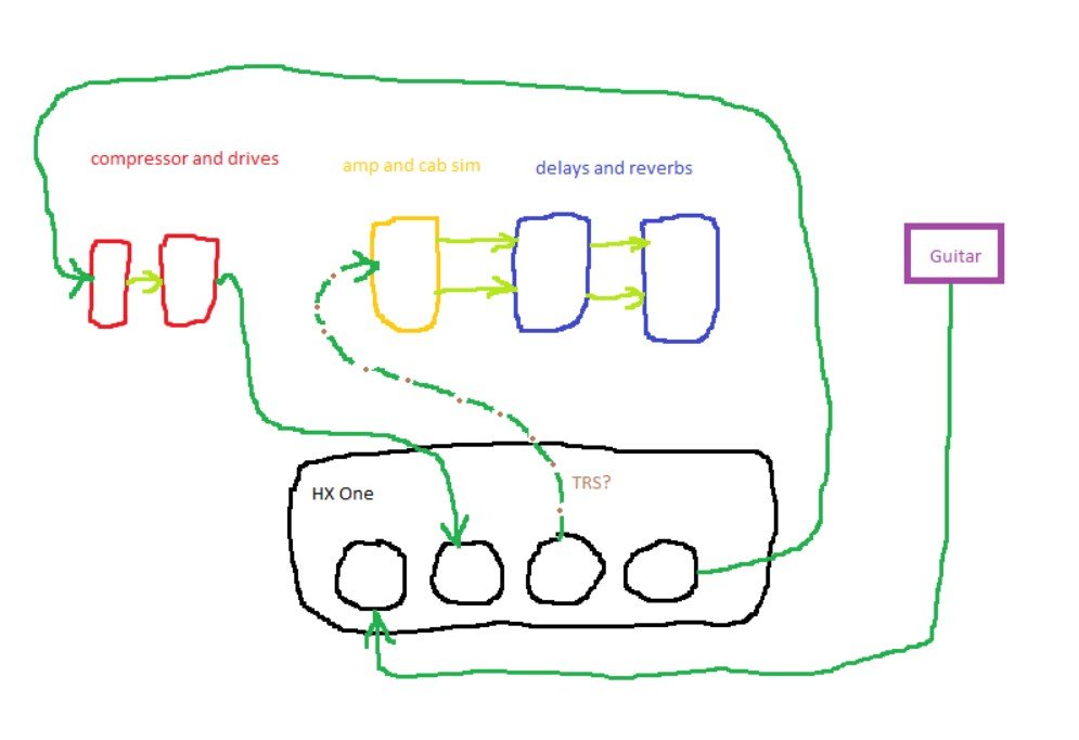

I plan to use HX One in my pedalboard with amp and cab sim, in 4-Cable method, to be able to place the effects in 2 places in my signal chain (I want to use drop tuning as well as modulation).
You can see my signal chain in the picture.
Guitar -> HX One(drop and octave) -> Compressor -> Drive -> HX One(distortion and modulation) -> amp & cab sim -> delay -> reverb
My question is:
Is it possible to take advantage of stereo effects in HX One when running 4-Cable method by using TRS Cable? If possible I would run TRS cable from HX One to amp & cab sim.
Thank you

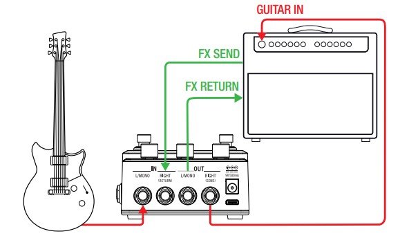

The manual suggests that the answer is No. It mentions only TS (mono) output for each jack. You need to use both L and R jacks to get stereo. Experiment with TRS abut I expect it won’t work.
Use unbalanced 1/4" TS cables to connect to
your guitar amp or other pedals. When connecting to a mono pedal or single amp,
connect only the L/MONO 1/4" jack.
