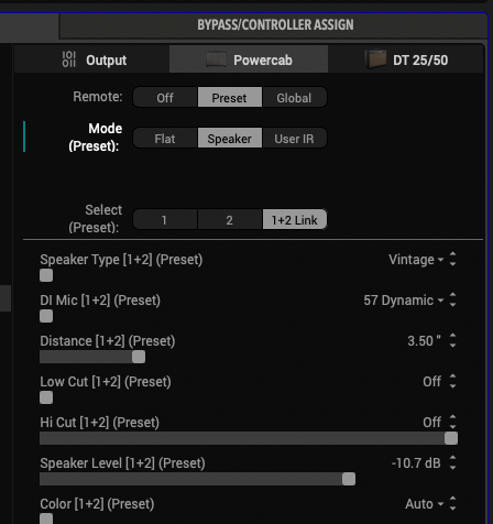

danielmxli Posted April 14 Share Posted April 14 Hi! I have my Helix connected via AES to the Powercab Plus (112) and things sound great when on Flat mode As soon as I change to Speaker mode, all sound cuts off. No output is heard anymore. Some troubleshooting I've done: * I've made sure on my Helix > Global Settings > Ins/Outs > Digital Output is set to AES/EBU * When I change the Speaker Type (via HX Edit) to anything (e.g. Vintage, Green, etc.) the knob color on the Powercab Plus changes accordingly, so I assume data is being transferred correctly btwn Helix <> Powercab... * I've tried turning my Helix Volume all the way up. No difference Anyone run into this before or have some thoughts ? Thx so much in advanced! Quote Link to comment Share on other sites More sharing options...
waymda Posted April 15 Share Posted April 15 I'm not near my gear atm, and haven't run speaker models for quite a while. However, when I did I ran through the multi output. Worth a try? Quote Link to comment Share on other sites More sharing options...
rwandering Posted April 15 Share Posted April 15 This certainly works for me. My Helix presets all set the FRFR or a specific speaker, and it moves between them without a problem (using AES). Quote Link to comment Share on other sites More sharing options...
rd2rk Posted April 17 Share Posted April 17 Have you solved this yet? All is well on my system. Quote Link to comment Share on other sites More sharing options...
