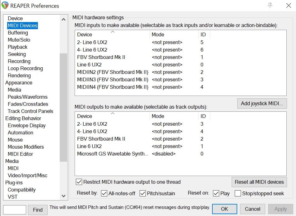

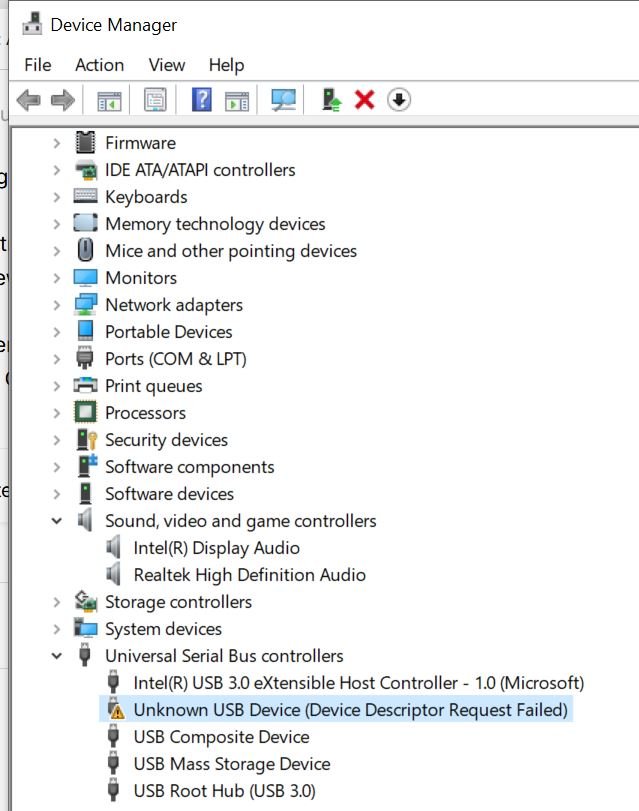

brandt4u Posted August 11, 2025 Author Share Posted August 11, 2025 Thank you silverhead for your reply, unfortunately in my case (attached screenshots) my computer/DAW does not recognize it, I tried several steps for troubleshooting, as we know there is no Win10 driver for mobile keys, I do have the (win7) 1.04 driver unfortunately I cannot execute it via L6 Central and L6 Monkey no longer works, I appreciate your help and technical advice, I want to use the controller, what can I do? Quote Link to comment Share on other sites More sharing options...
